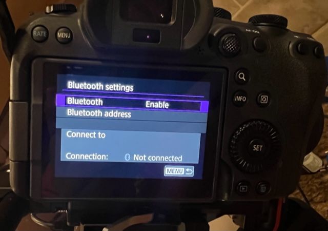

ok so i was able to install the firmware,
The radio antenna icon is still not there. Bluetooth options are there but they aren't working or they are grey'd outIMG_9991.jpg. I did check and Airplane mode is off, adjusted the dial to P and checked other menu's and it still not there. i'm sure it's something very simple that i am overlooking. i keep tapping on Enable but nothing happens...
08-13-2023 09:07 PM - edited 08-13-2023 09:16 PM
What was the menu shown before the one in your picture? It looks like Bluetooth is enabled according to your picture.
You could try resetting the camera back to factory default settings (along with custom functions).
08-13-2023 09:13 PM - edited 08-13-2023 09:21 PM
Also, I believe that Wi-Fi has to be enabled for Bluetooth to work, if I am not mistaken.
I would recommend downloading the manual from Canon support site and read up on how to set up Bluetooth communications.
