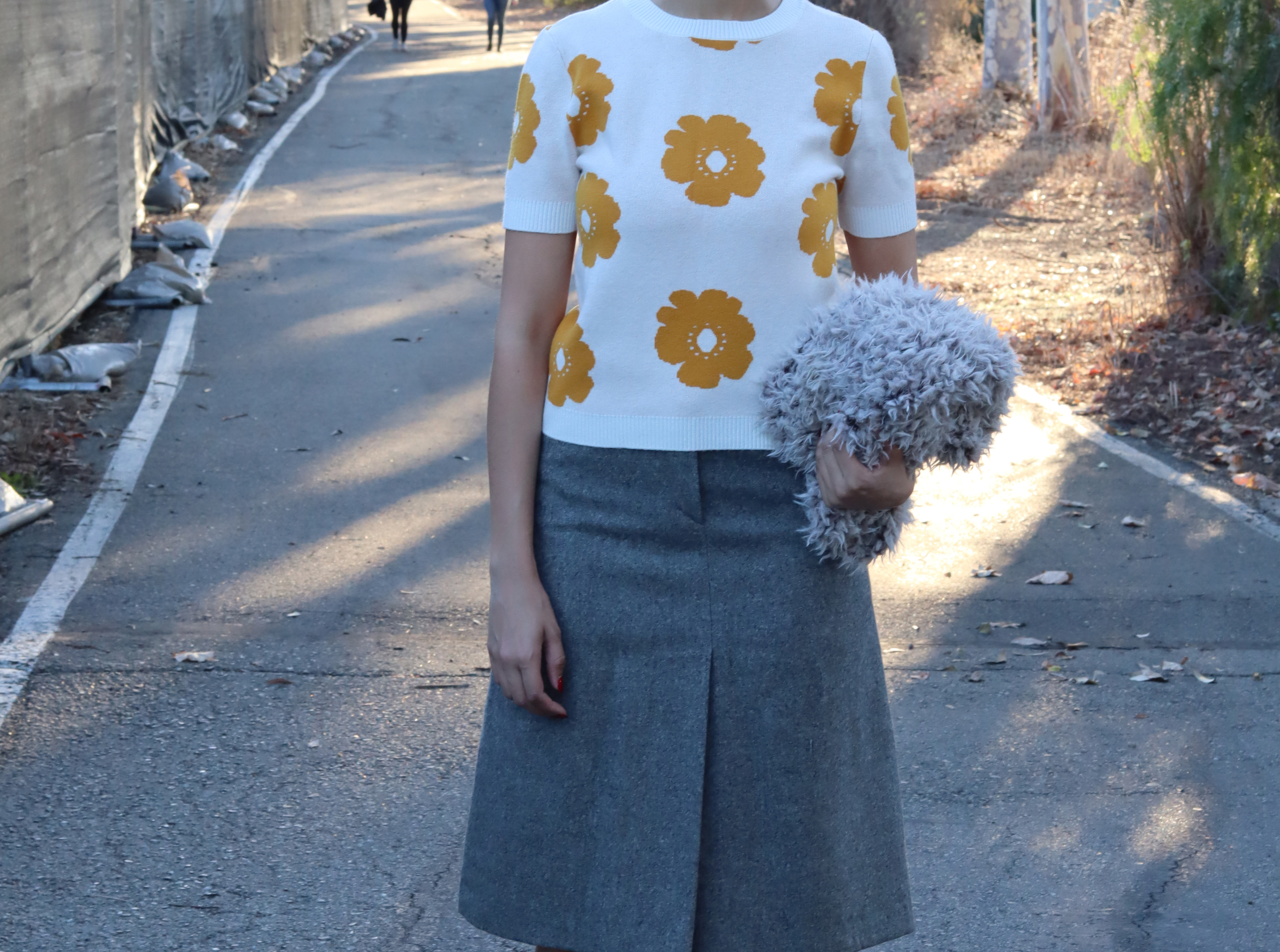

After running through a bunch of hypotheses, I finally have (what I strongly think is) my answer. TL;DR: it was shutter speed, and remained undiscovered till now due to the Av mode on my M50 being *way* too liberal with it. Plus I had a secondary win described further below.
So as you know I considered sensor size, post processing, aperture, file format (not listed in the OP, but it was one of my considerations), stability, etc.
My strongest candidate was aperture. As mentioned, I had previously been shooting almost exclusively at 1.8 with my 50 and it made plenty of technical sense that that could cause the murkiness in the detail. So for my next shoot, I went between 2.5 and 4 for my shots, but that didn't really solve it, so I went back to the drawing board.

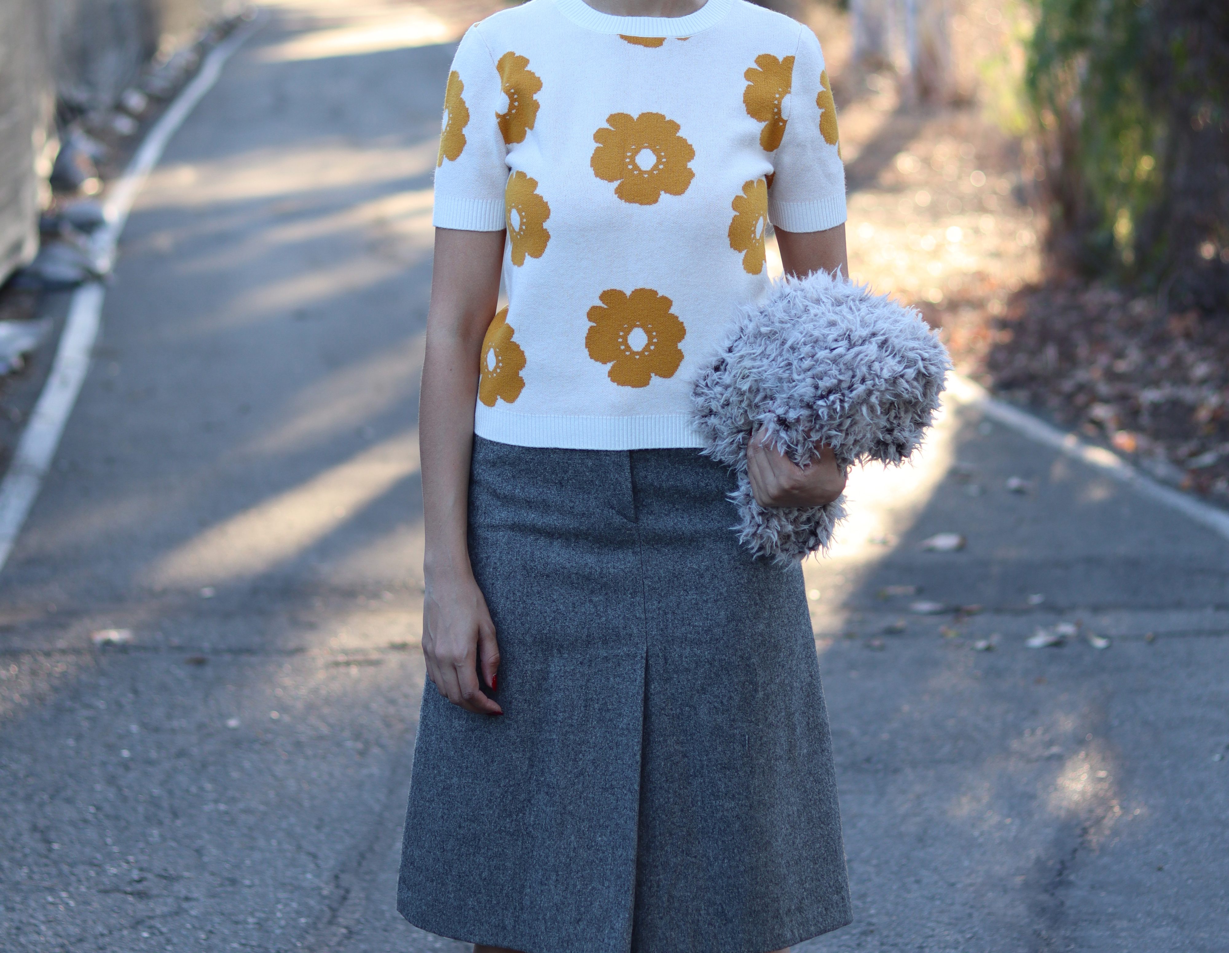

I had my model put on a few different-patterned fabrics. We did some shooting and only one shot came out super crisp. Hmm. I saw in the EXIF that it was the only one shot at 1/200, all others were at about 1/100-1/80. I'll spare you all the in-betweens and just show you two clear examples:
vs.
Note that that second one exhibits exactly what was driving me mad- that sharp but not really tack-like quality. A little fuzziness, a little aberrated.
