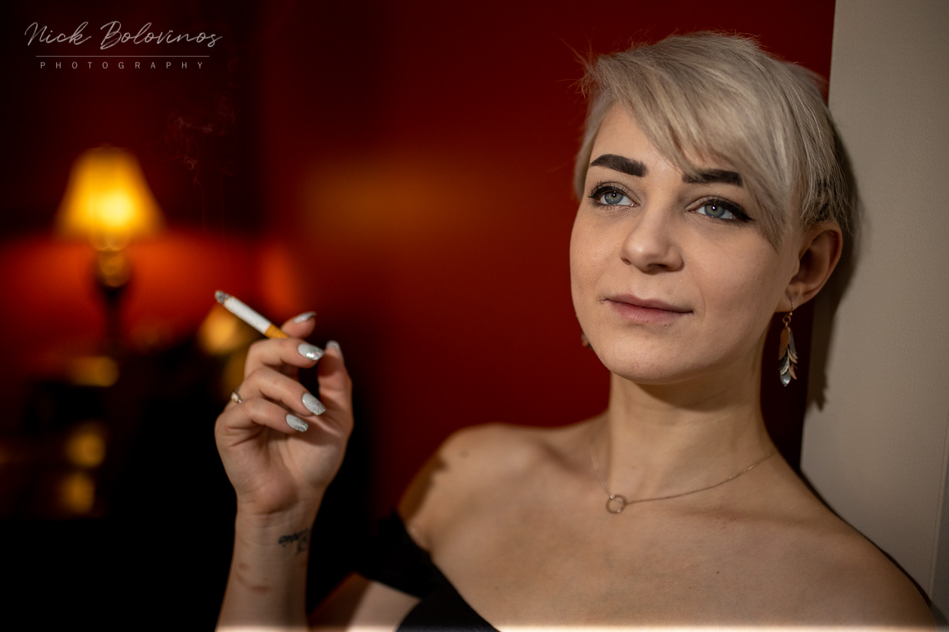

There seems to be a bright overexposure running along one edge of my photos, seems to be the bottom of the censor maybe. Anyone else experience this? I am using a Canon EF adaptor and a Sigma 35mm lens.

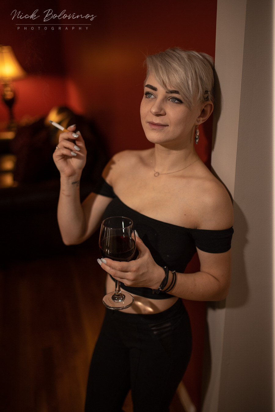

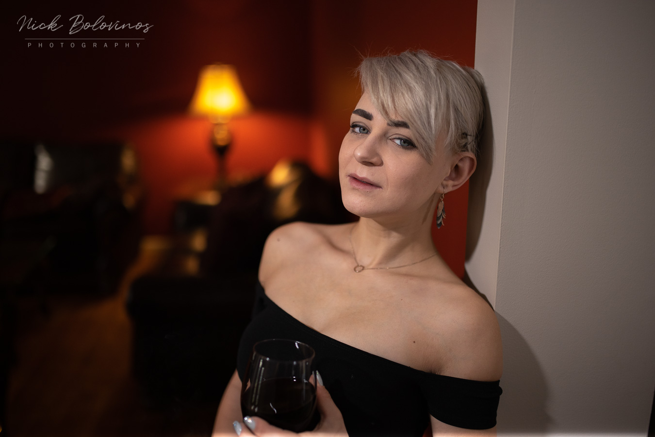

Here are some photos, not sure if its ok to post them here.

The bottom or the right side when camera is rotated. You can see that bright strip.
