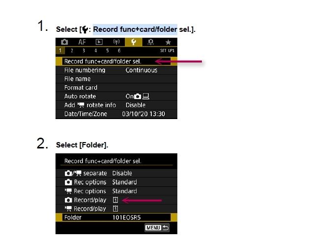

Page 746 of the advanced users guide will show you how to set up your cards for various recording options. I've attached a screen shot from the manual that that will give you a quick way to check to see which card is set to Play. More than likely card 1 (CF Express) is set to play. But, TBH, I don't remember what default is because I have my cards configured to "Multiple" and set to duplicate (I have Raw on both cards).
I have card one set to play and use card 2 (SD) to transfer files to my computer. Once safely on my computer, I delete and format card 1. I also use card 2 (SD) to update firmware.
This is the folder option menu, but it shows you your Record/play selections.
