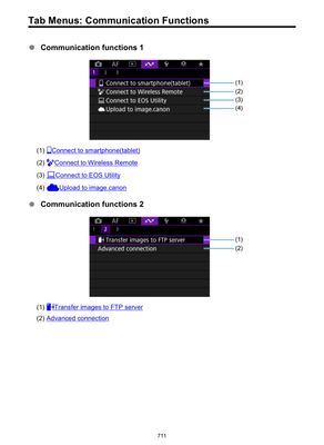

Waddizzle
I’m don’t think anyone asked about checking the communication mode setting.  I don’t have my camera with me. But, I think that you need to tell the camera what type of device it should be pairing with, in addition to enabling Bluetooth.
Check the. 1st Wireless menu.
