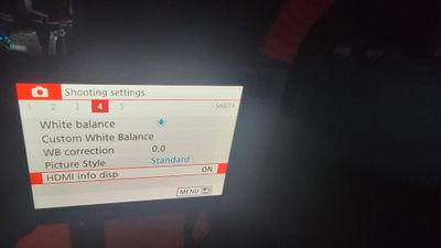

First off, thank you so much for your speedy reply! Right, so here is a youtube link to ALL the settings. I saw nothing in there (besides that auto turn-off feature, which is disabled) that relates to this issue. Please let me know if I missed it. I still can't get over how fast you responded, seriously, thank you for that. Gives me a bit of hope knowing these forums are so responsive! Below is the link to see all the settings on the t8i.
https://youtu.be/iuiauxYui7Y
Waddizzle
Your T8i is not capable of true “Clean HDMI” output. None of the Rebel bodies can.  Any [YouTube] claims to the contrary are unreliable work [arounds].

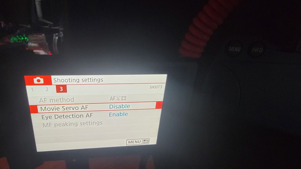

That said there is a "secret" (I guess) mode that only exists in "P" mode. Here, lets look at the number of options available in our menu in the red section, when NOT in "P" mode... Note that their are "3" pages right?
 Okay, so now in video mode still we switch to "P" mode.
Now see how many options we have...
So 5 pages instead of 3! And:
NOW that said, your probably right about the clean HDMI thing even though the option exists. BUT, I wanted to point out that menu (crazy right? I had no clue! LOL). Anyway I use a 4k Elgato cam card, so I have clean HDMI anyway.
