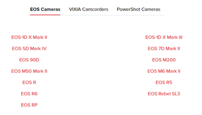

They're there! Bear in mind, this list is only slightly outdated! 😂
Scroll alllll the way to the bottom of https://canon.us/livestream then expand the Clean HDMI solution section. Scroll down some more, and you'll see this:
Since the pandemic, though, we've not only started putting clean HDMI in more of our cameras, but our newest cameras also can live stream without any additional software!
Like I said above, I use my Rebel T7i - to get clean HDMI, I have to turn off autofocus, which isn't a problem if I'm using a high-quality lens and just streaming something stationary. It's not ideal, but it worked for me until the EOS Webcam Utility Pro came out.
