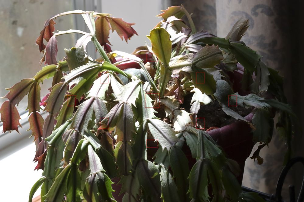

LOL! Thank you. I have that camera, and still use it. It sets beside my La-Z-Boy with an EF 100mm f/2.8 IS USM Macro lens attached. I have never used A-DEP (until today).
In A-DEP, the camera adjusts your aperture to include all of the registered (green) focus points. It works OK, but you are limited to shooting in only the best (well lit) conditions. ISO is the only thing you can control. It would probably work well for group photos at a distance.
I just took this and got a screen grab from DPP4 so you can see the focus points. It is in our window with bright sun. EOS XSi in A-DEP mode, EF 100mm f/2.8 Macro IS USM, 1/90th, f/11, ISO 400. Hand held 🙂
Canon EOS XSi A-DEP ModeCanon EOS XSi A-DEP Mode
