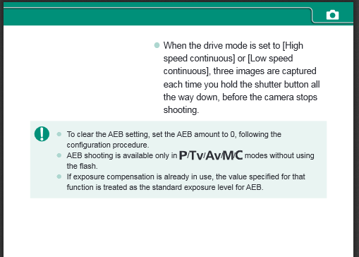

11-30-2019 10:18 AM - edited 11-30-2019 10:24 AM
It sounds like you have the camera set to One Shot or Single Shot mode. According to the manual it looks like you'll want to be in Low Speed or High Speed Continuous Shooting mode. Check pages 122 and 123 in your manual for more information.
Either that or you are pressing and releasing the shutter button too quickly. It sounds like the shutter button has to be held fully depressed until all three exposures are taken.
I suspect that both AE Bracketing and AF Bracketing work similarly.
