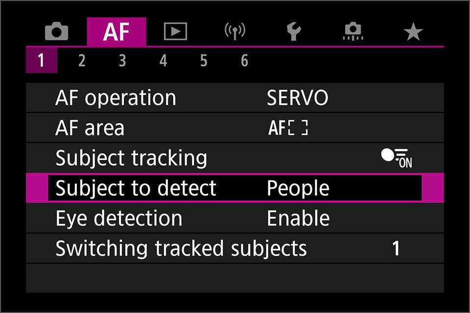

The problem is most likely the lens, not camera or the adapter.  First and foremost, the lens was designed for use on DSLRs, not MILC bodies.  Most third party lenses designed for DSLRs are not fully compatible with the advanced AF and subject tracking features found in the advanced Canon R Series camera bodies.
Disable all settings that enable eye or subject tracking.  You want to see AF points that look like grid of small AF points or boxes.  I use these setting in my R6 Mark II with the Sigma 150-600.
I recommend disabling the “Continuous AF” feature described above.  It creates an increased drain on the battery.  This feature is most useful during action photography scenarios, when the camera is almost constantly pointed toward your subjects.
I do have the Preview AF enabled.  I will try turning it off and seeing if it helps.
My R7 doesn't have the setting that you show in the screen shot.  Mine says "Subject Tracking" instead, and I have it turned on because I DO want the AF to detect and track the animals that I'm trying to photograph.  If I disable all of the advanced subject tracking features, I might as well use the lens with my old Rebel T4i that doesn't have those features.  The lens works fine with that camera where no mount adapter is needed since it can accept the Tamron lens' EF mount directly.  But my goal is to have the lens work with the R7 to take advantage of the R7's features.
The names of some terms does change from the EOS R7 (and EOS R10), this screen is from an EOS R7.
Subject tracking is the description used by EOS R7 in place of Whole area tracking servo AF found in the EOS R6 Mark II.

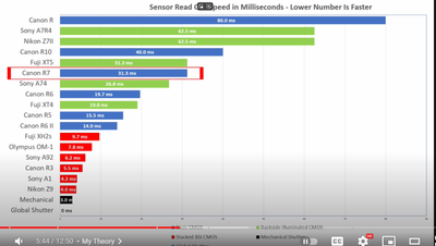

Paton showed the following graph to demonstrate the relative focus speed of the R7 vs. other popular models and that it is fairly pedestrian.
