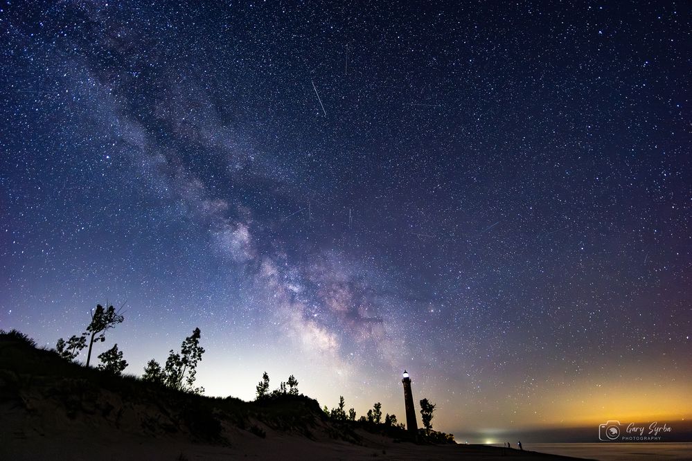

I have a question on some night sky images I have been taking with the R6 Mk ll.  I should mention first that I am not new to night sky photography.  I've been doing it since pre-digital days.  I've also shot a lot of night sky images with 4 different Pentax DSLRs, 3 different Canon DSLRs, and now 3 different Canon Mirrorless bodies.  The R6 Mk ll is the first camera I've experienced the following with.
If you look at the two attached images, one is nice and clear, the other seems to have a bit of a rotation to the whole image.  I've only shot night sky images a few times with this camera.  Last month I saw about 10% of my images had this weird rotation.  I wrote it off as shifting sand around the tripod.  Last night I was out taking about 100 shots.  Very sporadic, but roughly half of them look like this.  This last one was taken in the parking lot (solid ground - no shifting sand).
Few notes:
* Camera set to Manual mode
* IS turned off in camera
* The tripod is solid, tight connections on legs and ball head, and far from being underrated for this gear weight.
* I've used two different lenses where this is happening.  Rokinon 14mm F/2.8 EF mount... Venus Optics Laowa 15mm F/2 RF mount.  Both of these lenses are full manual - no auto setting, so the camera is set to shoot without a lens.
Am I missing something in the settings that is new to this specific camera?  I've never had this happen on any other camera.  Also, I only see this in night sky shots, when on a tripod.  Day shots, on a tripod are never a problem.

The Rokinon is an EF mount, and I have used it often for night sky photography on the following... 60D, 80D, 6D, RP and now R6 Mk ll.  Never had any problem with the other cameras.  All hand held daytime images with this lens are fine on all of the above cameras.  I think we can rule out this lens (and besides, I sold it when I bought the Laowa 2 weeks ago, so I can't test further).
The Laowa is new, I have only used it on this camera and the R8 (which is converted to infrared, so I use it during the day).  Hand held daytime shots with both the R8 and R6 Mk ll are fine with this lens.
I am going to set up tomorrow with a strong ND filter and do some daytime long exposures on a tripod to see if I can get the same weird effect.  I will also try with the R8 on a tripod to see what happens.  However, since both of these lenses do not have any electronic communication with the camera (both are full manual), and since the movement/rotation/pattern is identical, I really do not think it could be the lenses.
Additional notes...  I've used the R6 Mk ll three times now for night sky photography (Milky Way, and/or aurora).
The first time was with the Rokinon EF lens back in April.  Did not experience this problem at all.
Second time was in May.  Again with the Rokinon.  Maybe 100ish images, roughly 10% had this effect. Same tripod, same location, same conditions, same settings.
Third time was last night.  Only difference was the switch to the Laowa, but other than that same tripod, same location, same conditions, same settings.  Roughly half of the images had this effect.

Gary,
If you take the "bad" photo that you provided, and blow it up quite a bit, you will see some kind of ghosting affect all along the Ridgeline to the left of your watermark. It almost looks like your camera has shifted down and to the left.
I do not know if this is related to your stars, or what might be causing it.

Steve, I agree about the shift down and to the left.  The odd thing is that on two separate occasions shooting night skies, with two different lenses, I have the exact same shift, degree of rotation, amount of movement, etc.  I'm pulling out lens issues since it was two different lenses, and rolling out tripod issues since the amount and direction of movement is identical in over 60 images, covering two separate nights of shooting.

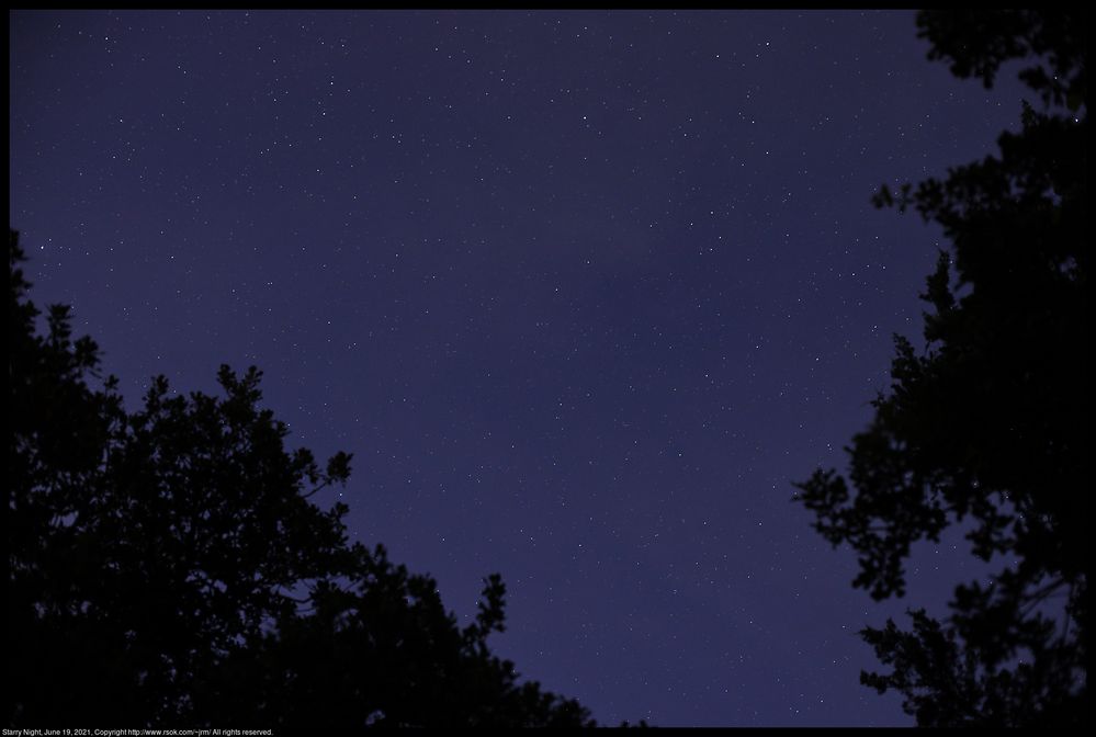

I do not know much about astro, but that does not stop me. https://www.rsok.com/~jrm/2021Jun24_birds_and_cats/2021jun19_stars_IMG_1931c.html
A starry night in Norman, Oklahoma on June 19, 2021 ;A starry night in Norman, Oklahoma on June 19, 2021 ;
Artist John Moyer
F Number 1.4
ISO 800
Shutter Speed Value 6.2 seconds
Focal Length 50.0 mm
Lens Model vintage MC ROKKOR-X PG 1:1.4 f=50mm
Hyperfocal Distance Inf m
The lens is from a Minolta film camera and was made nearly 50 years ago. If I had stopped it down to F/2.0 there would have been less coma. My skills have improved some since then and the firmware is improved. We have hazy skies here lately with smoke and too much humidity.
