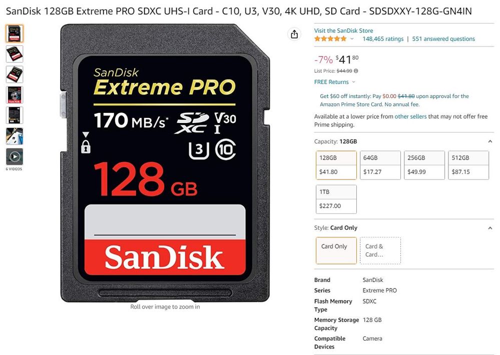

This one: SanDisk 128GB Extreme PRO SDXC UHS-I Card - C10, U3, V30
Everything else disabled means that Wi-Fi, Bluetooth, GPS are disabled.
I did reach out to Canon and explained the issue. In their response, their first step is to try a new battery. The problem with that suggestion is that my issue goes away when I take out and then put in the same battery, so that will not tell me anything. And another layer of difficulty is that this happens rarely, so replicating it is almost impossible. And my fear is that this will become a bigger problem once I'm out of warranty.

[Commercial link removed and replaced with screenshot to facilitate discussion.]
04-26-2023 05:50 PM
I see that you are using a UHS-I card. I strongly recommend that you try a UHS-II card. These are currently on sale at B&H and other outlets.
