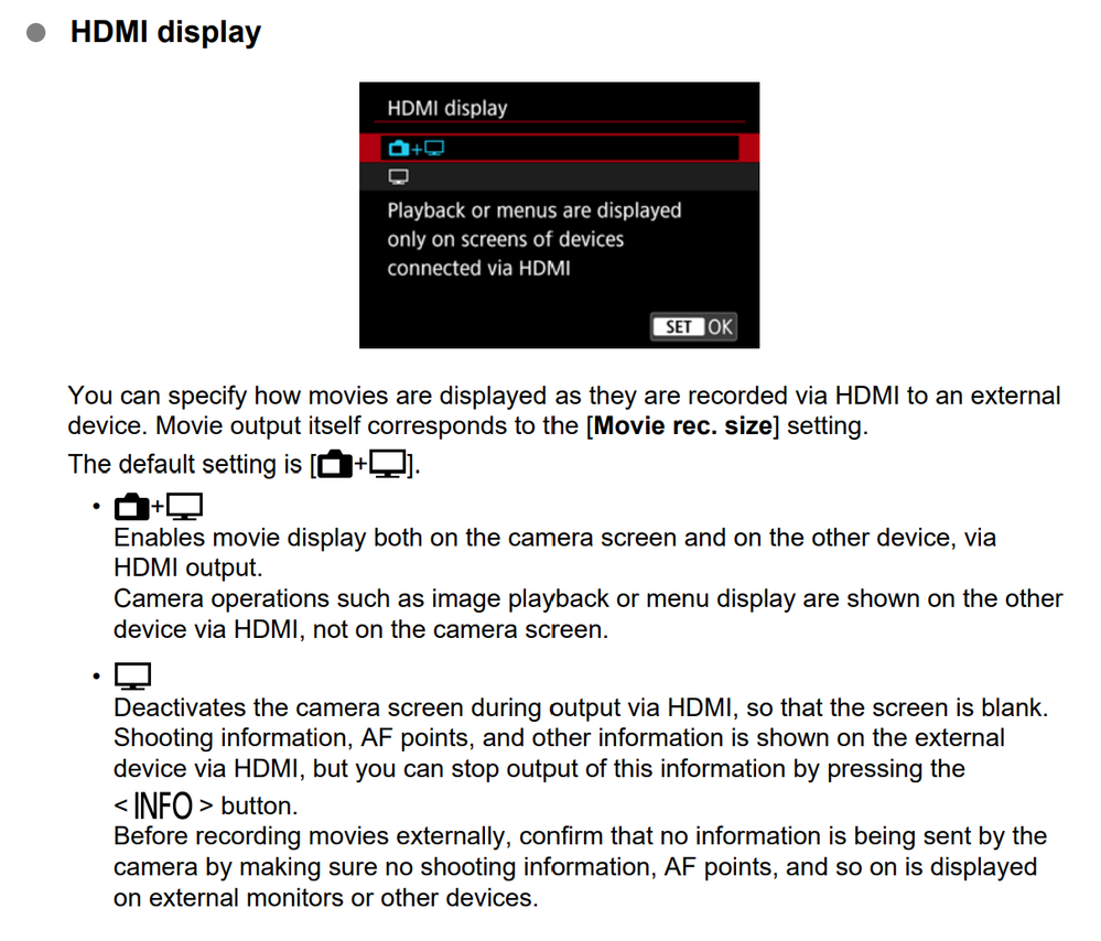

Clean HDMI is enabled. Have you checked these settings below. Make sure the camera is set to movie mode. These settings are NOT available in Stills mode. You can Click Here for the full manual. Check pages 373 and 374 in the manual for more information. Have you hit the "Info" button to see if those items are visible.

I have monitored only selected and it displays all the shooting information, AF points, etc to my external monitor. Everything but the grids.
