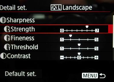

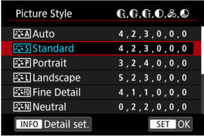

I am pretty sure that this symbol refers to the picture style (specifically contrast) that you are using, as per the advanced user guide, P213: From the menu RED chapter, P4.
If you press INFO you can see the symbols displayed in more detail.
Picture Style details with INFO buttonPicture Style details with INFO button
If you press INFO you can see the symbols displayed in more detail and this symbol is assigned to contrast.  The shading is possibly reversed on your display because it is a white background.
cheers, TREVOR
