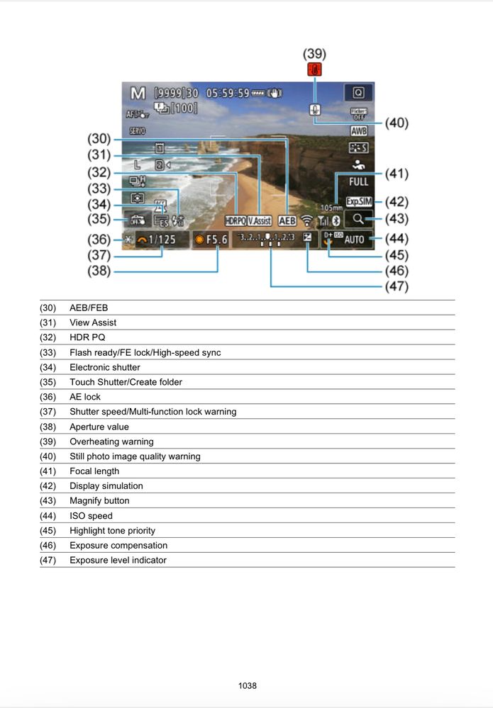

There does appear to be a setting in the manual that allows the user to select a “VF Display Format”.  The Instruction Manual does not provide illustrations of the differences.
This is what I found in the R3 manual that defines the EVF icons.  Everything I find only shows the exposure display on the bottom, never on the right.
