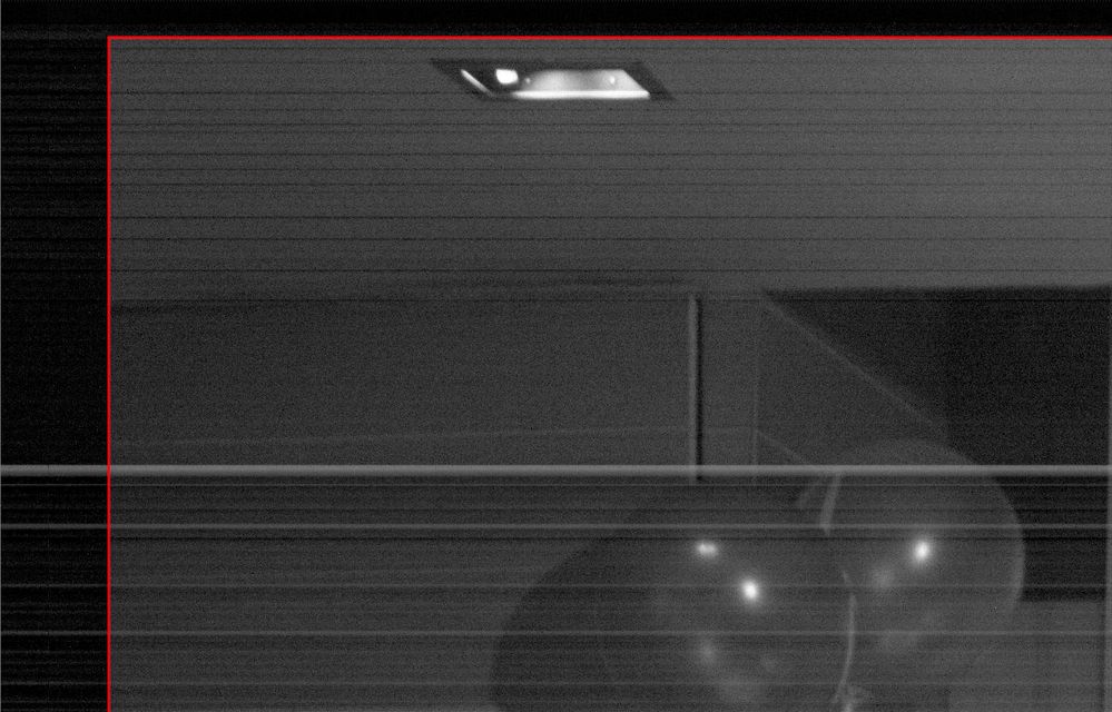

A pink line appeared on my screen while shooting on my R6 (less than a year old). unfortunately the line is on the images. Same issue with different cards and it's consistently there.
I haven't brought it back yet, but my biggest issue is how to fix the images?

The lines are moving around and a dark frame will not work. Do you get the same error with the original battery?

Is there's anything I can do to fix the photos?

Because the lines also are visible in the hidden masked pixels to the left in the raw file I thought I could remove them with something against dynamic row noise. It did decrease, but not much.
Masked pixels
The tool is available in the RawTherapee fork Another Rawtherapee (ART). You can ask the developer if it is possible to improve your raw files with the tool, https://discuss.pixls.us/c/software/art/36
