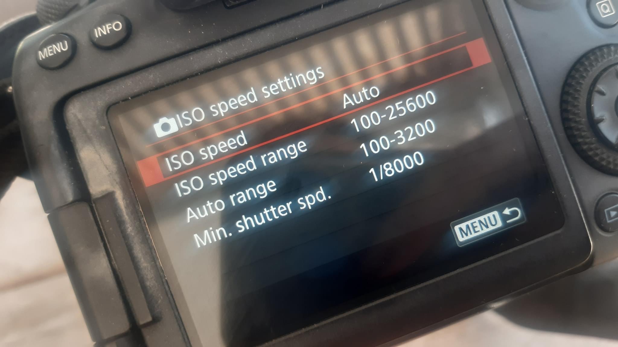

It sounds like a Safety Shift is kicking.  There are actually more than one Safety Shift setting in Canon DSLRs.  Look at the bottom setting, which sets a limit on shutter speed.
This is the one that everyone tends to overlook.  It is in the ISO menu.  The default is 1/125.  This setting only kicks in when you are shooting in P or Av modes.  I am willing to bet someone dialed this down to 1/8000 to get faster shutter speeds.  There is no way to override this setting, except to dial in 1/8000.
Min. Shutter Speed on my camera is set to AUTO.
The AUTO setting means that the focal length of the lens will determine the minimum shutter speed.  The AUTO setting is the actual default.  When you dial in a manual setting, the default is 1/125.

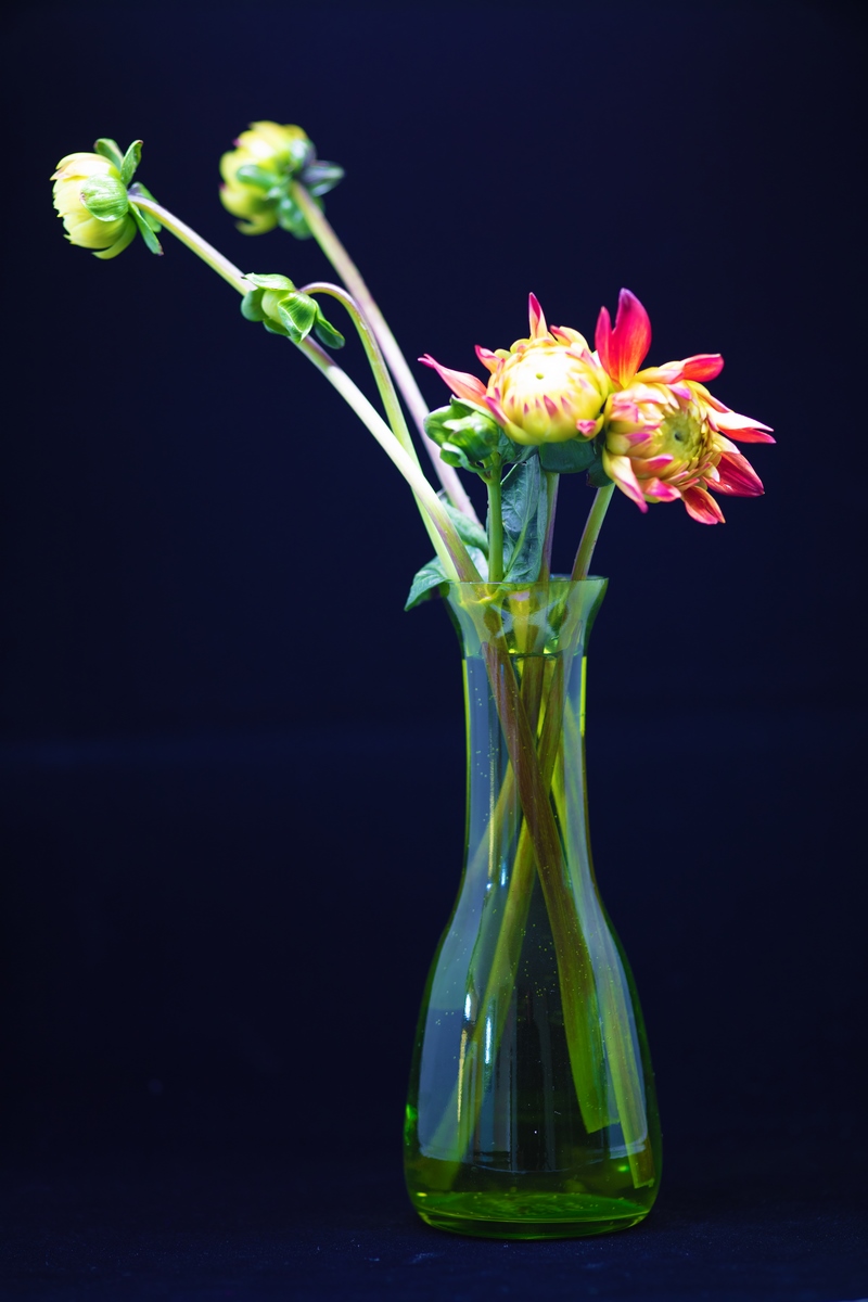

The attached image is an example.  I did not use a flash nor did I have the lights turned on in my white/black box.  And yet, the image is way to bright and blown out in parts.  The background should be jet black and even it's light.  It's almost like it is ignoring the ISO setting (which in the image below is 100 and boosting it very high) and or the shutter speed is being ignored for the apperature setting and slowing way down.  The details for the image below are:
Canon EOS 5DSR
Canon EF 180mm f3.5L Macro USM
f/3.5
1/4 sec.
ISO-100
180 mm
No Flash
Tripod & Shutter Release
In order to get a decent shot even in this situation is to crank way down the Exposure Compensation.  Which is really odd as there is no flash or external light on the subject.  Again, this has only recently started happening.  I am stumped.

EXIF data indicates you used matrix metering. The black background is a significant part of the image and the exposure system is targeted to an overall middle gray.
The histogram for the image you posted looks like this:
The spike is driven by the black background.
But since the cmaera wants to see middle gray I suspect your out of camera histogram/image looks sort of like this:
Negative 2 or so exposure compensation to make middle gray black is not unusual.

It is probably because you are processing in Adobe, but I noticed in the EXIF data that it reported the wrong focal length for the lens (105 instead of 180mm)  I was curious if there was an issue and grabbed a file I shot with my 5DS R and EF 180 f3.5, processed through DPP and the EXIF shows the correct lens and focal length identification.
The ISO is reporting as set according to EXIF and you were shooting with the f3.5 wide open so it isn't like you had selected a narrower aperture and have an issue with the aperture blades sticking at the point of exposure.
Set the camera for manual operation with the aperture @ f3.5, shutter at 1/4, and ISO at 100.  Set metering for spot and meter off the center of the blown carnation.  With this setup, does the meter in the camera show it is seriously over exposed?
