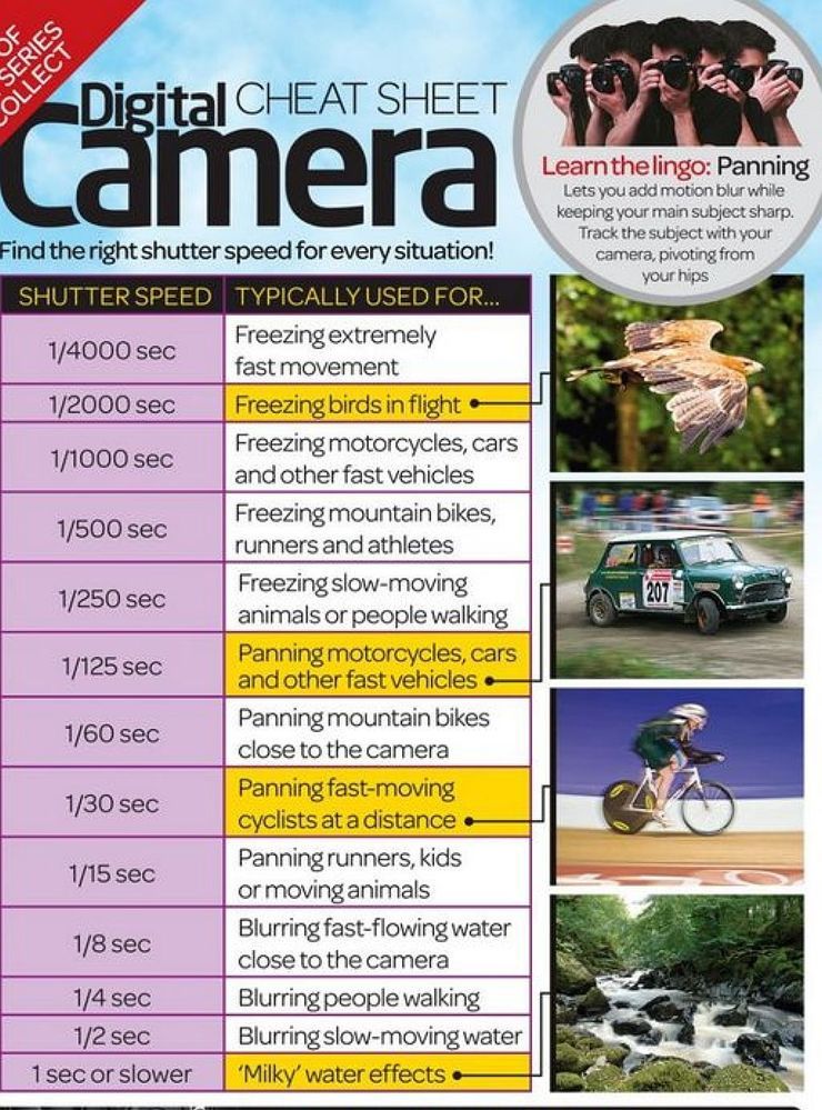

Hey Broc, thanks for the follow up information. The simple answer is that your BBF is really set up best for moving targets, in servo to track subjects. You should keep the button depressed as you target is moving and the focus will need to adjust. The star button , static subject press it obtain focus and release. If the subject hasn't moved you focus is locked and should be sharp.
Again there is several elements that have to come together for capturing birds in flight some of which have nothing to do with the camera set up. You stated that you shuttered the camera when the subject was on the right side of the screen. That is a result of your panning speed when tracking the bird, you fell a bit behind and the bird almost left the viewfinder when you shuttered the camera. Auto focus will perform best away from the edges of your viewfinder. Also, your shutter speed may have been a bit slow for BIF. As Trevor stated in another post, hit rates for birds in flight can be low, especially when you first start out.You have set up your camera for wildlife and now you simply need some practice. Your shutter speed may have been a bit slow for this capture. While you are practicing you may want to keep it a bit higher.
  • Pan with your subject and attempt to keep it in the center of the frame.
  • When possible shoot with a shutter speed of 1/2000 or better.
  • Attempt to get as close as possible to your subject. Remember that atmospheric conditions such as heat or wind can impact focus. When at the beach water spray can have the same impact.
  • The direction of the birds flight will impact the cameras focus. A subject moving across your path or away from you will be more difficult than a bird flying towards you.
  • Your hit rate will improve with practice, it's not always the equipment.
https://www.naturettl.com/understanding-autofocus-points-and-modes/
This Kildeer was shot with my R5 and the RF100-500 lens. I had to push my shutter speed to 1/4000 because my first attempt @ 1/2500 failed. These birds are fast and fly erratically. I shot several frames and had three tack sharp images, this is one. And if you would have been watching me in this field you would have thought I was crazy, that bird spun me around for quite some time and I kept walking towards it to close the distance to the subject while I was taking pictures.

Thank you soo much. This is awesome advice and I will take it to the field. So I know I need to change my AF from Single point to a more dynamic set up for these birds in flight. Hold down the AF-ON while the subject is moving or panning..  I was shooting in a very hot desert area. This is down by Imperial Valley Ca. Where tempetures exceed 120 degrees F’ so we get a lot of weird mirages etc. So just to recap I am going to use my star button for single point focus, stationary items/animals and use the AF-ON to obtain and hold focus on moving item. Hold the AF-ON while also increasing the Shutter speed above or at 2000 for fast moving birds or animals. I know there is more to it and I am learning little by little. I do appreciate you taking the time and helping someone you do not know with all these questions.
