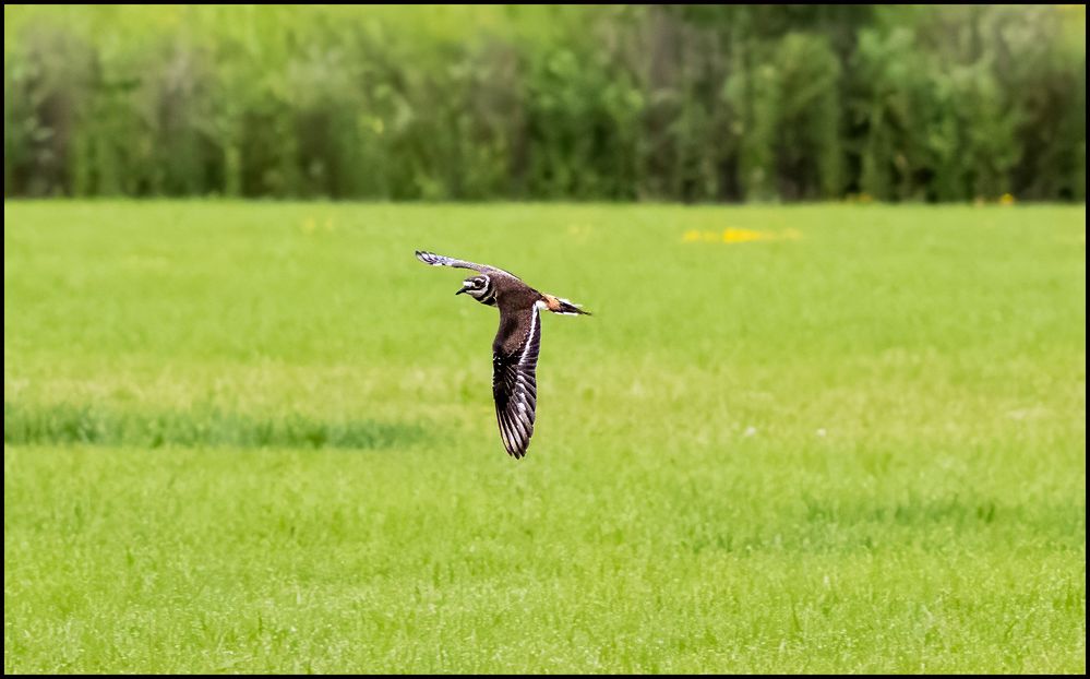

This Kildeer was shot with my R5 and the RF100-500 lens. I had to push my shutter speed to 1/4000 because my first attempt @ 1/2500 failed. These birds are fast and fly erratically. I shot several frames and had three tack sharp images, this is one. And if you would have been watching me in this field you would have thought I was crazy, that bird spun me around for quite some time and I kept walking towards it to close the distance to the subject while I was taking pictures.
