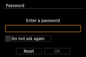

After the firmware update, when you first turn on the updated camera, you'll be asked to set a PIN/Password.
When you power up the camera a second time it will request the PIN, but you should have an option to "Don't ask again". Selecting this option will prevent the password screen from appearing every time you use the camera.
If ever you reset the camera to factory defaults you will need to go through this exercise again.

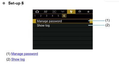

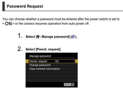

Go to your Wrench Tool Menu drop down there you will see "Manage Password". Click on it and you'll see a menu with the following options:
Pword. request OFF
Change Password
Clear entered information
Simply turn the password off
Wrench menu may vary by body but it remains in the wrench menu regardless of the body
