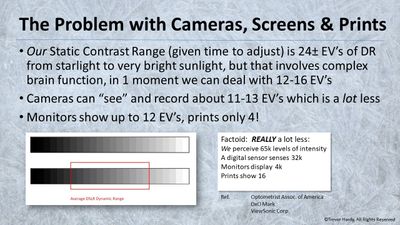

Where precisely in the image are you most bothered by the noise?
If it is in the areas of shadow, that is perfectly normal because of the high level of contrast between the bright sky and the very, very dark shadowed cliffs.  While we can perceive a vast range between extreme very bright and very dark, a camera sensor is much, much less capable of doing so.
In the image below the light changes from total white to total black in steps, each of which is a doubling or halving of the light intensity.  These are called Exposure Values (EVs) or Stops and are the common currency for measuring exposure and the control of it through Aperture, Shutter and ISO controls on the camera.  As you can see, we can perceive a lot more light variation than the most modern sensor.
Noise is normally a results of lack of light being captured from an area of an area of the Field of View (FoV) - i.e that view that the combination of sensor and lens captures.  In the case of the image that you have posted, you have correctly exposed for the brighter areas of the FoV and it will naturally happen that the shadowed area fall to dark or black.
