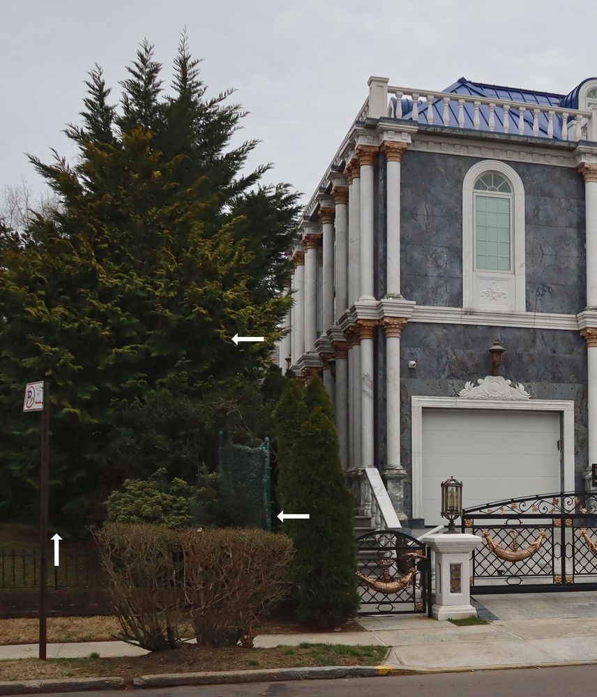

I'm a bit concerned, having thought that getting the m200 and using other lenses I have, the kit lens 15mm-45mm f/3.5-6.3 IS STM and perhaps buying the EF-M 22mm f/2 STM Lens would make for a great street kit. Taking some photos, the quality was very sharp and very nice. But many of the photos seemed to come out dark or like there is a haze. And then I noticed there was noise, banding and distortion, especially in lower lighted areas. Hence I wonder it's the glass that is really creating some of the mediocre images and distortions.
The first photo is one of the better ones. It's unedited and the colors and overall look is crisp. But it's not like a got much detail from the ducks, which I'd usually get with the old RX100 M1 I used to shoot with before it died.
Now look at the second photo. The house came out gorgeous, crisp and you can see the side of it in the photo I uploaded. But the tree next to it which had darker spots had noticeable blotches and distortions. Looks terrible. The third image with the duck is OK but there is a lot of noise in the background with fuzzy detail.
The fourth photo is better although, it too, seems dark and the details are lost in the dark quality. So I'm wondering if the G7X M3 would have performed far better due to the 1.8-2.8 lens that it has. Both have stabilization (m200 in the lens) and I'm wondering if it's the shooter or it really is the glass that won't produce the similar results. Many of the 'pros' I saw liked the m200 because they can use it with other lenses. But I'm noticing also that there isn't any EF-M lens that is versatle like the G7X as well - a 24-100 going from 1.8-2.8. Not the deepest Zoom but far better than 45mm at 6.3. It's the 6.3 that is making me wonder whether I'm losing so much detail and all these photos are dark.

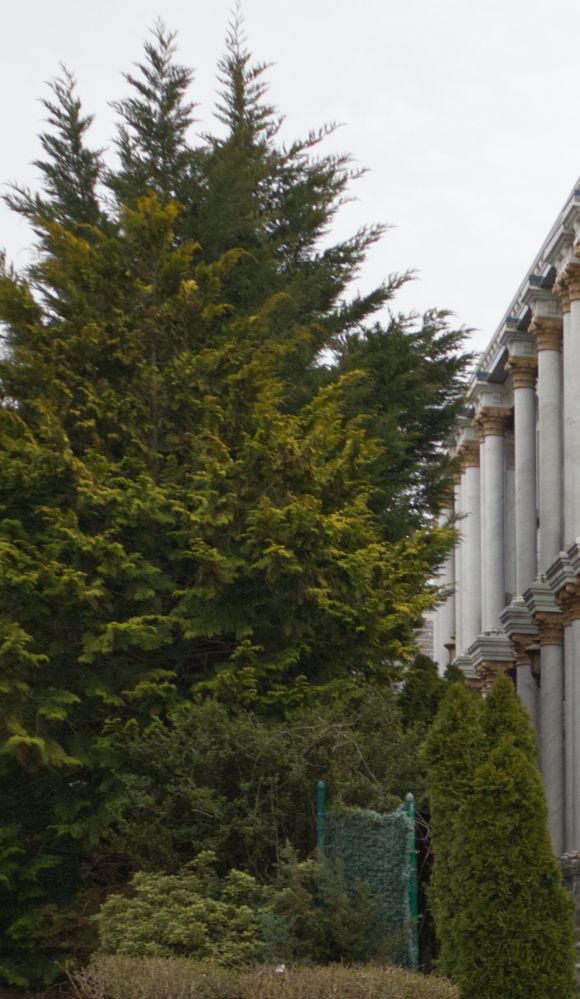

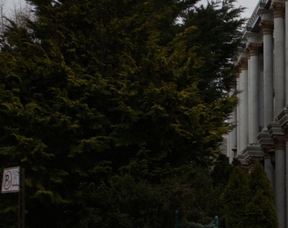

So here is an interesting discovery. I went in to the raw file because I figured best to edit the source - and the difference between the out of camera jpeg and the raw is astonishing. The first image is the JPEG with arrows pointing to the awful spots. Looking at the raw (I brightened shadows on all images), it's not even comparable.  I didn't even have to use the arrows because the awful distortion is patently obvious. This is likely out of camera jpg distortion and I guess it makes sense that darker images and bushes will distort the worst straight out of camera.
Here is the EXIF Information
Canon EOS M200
EF-M15-45mm f/3.5-6.3 IS STM
6000x4000
Exposure 1/500 sec
Aperture F3.5
ISO 320
Flash did not fire
Here is a close-up. It's not even comparable. I'll let you guys figure out which is the raw and which is the jpeg out of camera!

Just a bit more processing and your shot looks like this. Not bad really.
If I had the Raw file I could do even better. When you edit these do a WB adjustment in Levels first. Then check the histogram. Yours did not extend all the way to the right. So this was not a perfectly exposed picture or at least not as good as it could be. You can fix that in post especially in a Raw file.
