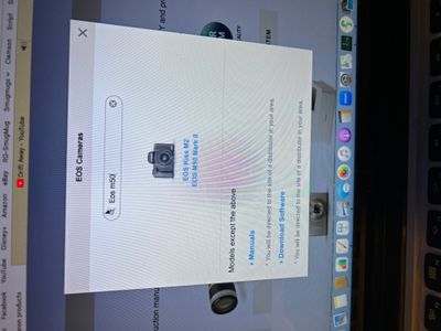

11-15-2023 12:42 PM
Canon has stopped carrying firmware and all updates for m50. Kiss M2 is only option when searching for m50
