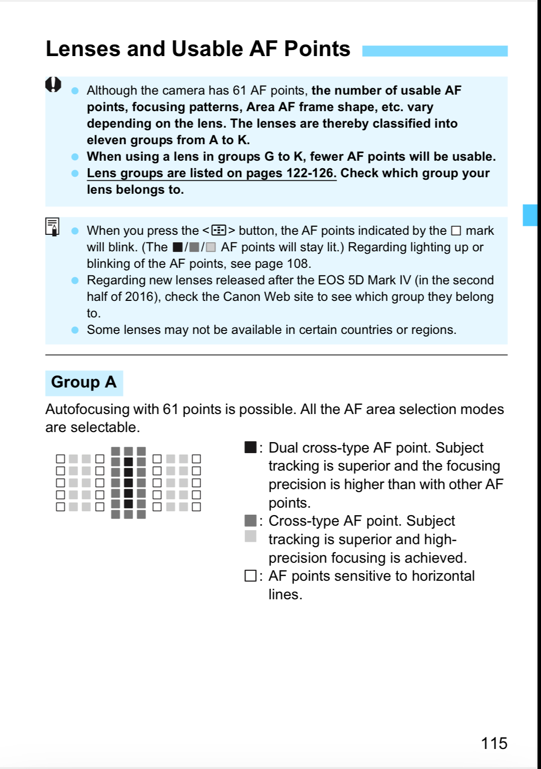

At first glance, I would point out that you are not using the most accurate AF point(s) in the camera.
Both of our lenses are "Group A" lenses.  This lens group yields the highest performance.
I do agree that your images could be sharper than how they appear to be.  The softness in the above images seems to be evenly distributed on the subject, which leads me to conclude that DoF is not an issue.  But, camera shake could be.
One Shot AF is faster and more accurate than AI Servo.  When taking portraits of still subjects, the subject must learn how to remain still, or freeze in place, until the picture is taken.
Thank you all so very much for your input and research.   I typically shoot schools and young children and families so shooting fast and with subjects that move is a priority.  I will research the focal points show below and see if I can't figure out what is going on.  It is literally making me crazy.  😞
