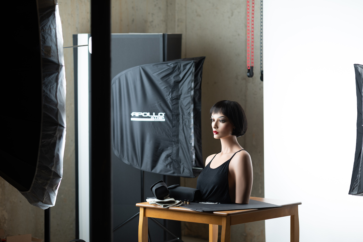

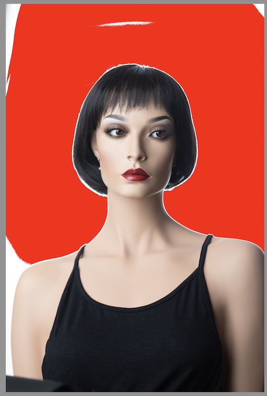

rs-eos
Quick test today where I was able to get the vast majority of the white background pure white.  Very little to do in Photoshop if wanting to get all areas at 100%.
The setup:
7' deep umbrella with diffusion (four speedlites at 1/16 + 0.3 power).  This was anged at the subject and would also contribute to lighting the background (more from the left-hand side as viewing the image).
Two gridded strip boxes on other side of the backdrop in groups B and C.  Did this since B needed less power.  B at 1/2 + 0.3 power.  C at full power.
Canon 5D IV with the 135mm f/2 L.  @f/2.8, ISO 100, 1/200s.
NOTE: I really like using telephotos for this as you get a narrow field of view and thus less width of the backdrop to illuminate.  I use 53" inch wide seamless paper.  I was also able to move the subject away from the backdrop as well.
What I specifically did.... Took separate shots with just group B on and then just with group C.  Adjusted power such that the histogram was just to the left of clipping (such that say adding 1/3 to 2/3 stops more power would then start clipping).  I figured that the main light would be contributing around 1/3 to 2/3 stops to the background.
Then, turned on the main to get a decent exposure for the subject.  Finally fine-tuned all power levels.  After about five images, had the final shot.
The setup:
You have simply proven point.  You cannot get it 100% perfect without some type of post processing.  Thanks!
I'll come back with a better image if I can ever convince my wife that I need Speedlite number 7 and 8 🙂
I could have added another strip (horizontal orientation) along the top of the backdrop and a second strip to deal with the lower left corner.
Your point is still valid; not all pixels will be at 100%.  However, with enough lights (or with modifiers of the right size that have very even output), you can get very close.
