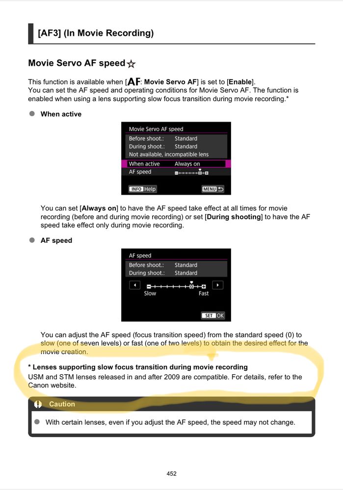

1st Party EF lenses released prior to 2009 do work. But certain features such as support for Movie Servo AF & 12 FPS don't work. Canon has a list of lenses that support the above mentioned features. My dad's old EF 70-210mm F/4 & my old EF 28-135mm F/3.5-5.6 IS USM lenses work when adapted on an R series body via the EF-RF Mount adapter. All functions such as aperture control, AF & IS work. As you said certain features won't work ie Movie Servo AF.
No, they don’t. Lenses released prior to the first Dual Pixel AF sensor in 2009 are not fully compatible.  This also applies to DSLRs with Dual Pixel AF sensors.
The above is from the R5 manual.  There is list of FULLY compatible EF lenses in the manual somewhere, too.
I mean as in basic use of the lens does IS, AF & aperture control work.

@deebatman316 wrote:
The manual doesn't state such things. Or at least I can't find that. Also AF, Aperture control & metadata are retained.
IBIS was not available when the camera was first released.  It may have since been corrected in firmware updates.  The basic issue was that the IBIS menu would go away when you attached an EF lens, sending IBIS into a 2-Axis mode.

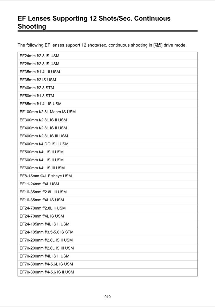

Many EF lenses are do not support the high frame rates in the MILC bodies.  For the last time, not all Canon EF lenses are fully compatible with RF bodies.
I know that Canon has a list of which support 12 fps. I'm just stating that pre- 2009 EF lenses will work. But there will be limitations based on the lenses that are used. Your making it sound like they won't work at all.

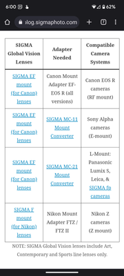

Although I have fully transitioned to Canon  RF glass.  I have many happy years with Sigma lenses.  I mentioned Global Vision earlier, which is Art, Sports and Contemporary glass.  This is from Sigma's website.  They only call out global vision lenses as compatible with the EOS R.
Adapt your favorite SIGMA lenses (compatibility tested by SIGMA)
However, we know that the 150-600c exhibits focus pulsing when adapted on the R7, as many wildlife photographers have pointed out.  The degree to which this occurs varies but the issue does exists on some lenses where compatibility is claimed.
Many EF lenses are do not support the high frame rates in the MILC bodies.  For the last time, not all Canon EF lenses are fully compatible with RF bodies.”
