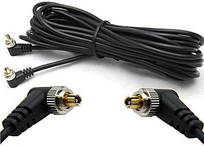

After ordering, I discovered the T8i did not have a pc port. This is the cord I ordered: FF03F5B8-BEA8-486A-B738-682B2E3A7FB9.pngFF03F5B8-BEA8-486A-B738-682B2E3A7FB9.png422434E5-394F-423A-9AC5-FF770779610D.jpeg422434E5-394F-423A-9AC5-FF770779610D.jpeg
This is what I suspected initially.  If you cannot add an additional shoe / mount to the existing cable you purchased, I'd return and get one that has the shoe / mount on both ends as I mentioned.
That is exactly what I plan on doing! I appreciate everyone’s input!
