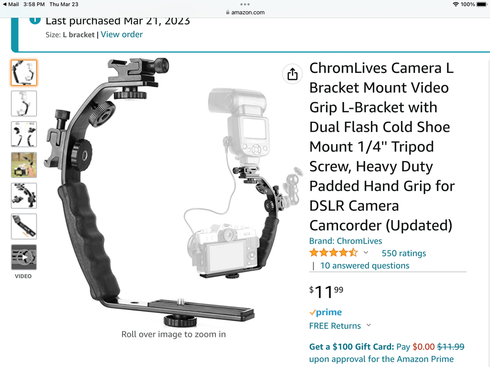

Hi, all,
I have a Canon EOS Rebel T8i camera.  I have recently been experimenting with off camera flash.  I ordered a bracket, with a hot shoe, that attaches to my camera, to get my external flash off the camera.  I have a sync cord but I'm not sure where, on the camera, the cord attaches and also where on the 580EX II Speedlite, the other end goes.
I would appreciate help!

I've alerted our resident flash expert to your post.  In the meantime, can you tell us what it is you've purchased?  The flash sync cable should essentially have two shoe/mounts.  One that mounts in the camera's hotshoe and the other that the 580EXII mounts on.  Maybe I'm not understanding what you are working with?  I do know that the T8i does not include a PC Sync port.

After ordering, I discovered the T8i did not have a pc port. This is the cord I ordered: FF03F5B8-BEA8-486A-B738-682B2E3A7FB9.png422434E5-394F-423A-9AC5-FF770779610D.jpeg
This is what I suspected initially.  If you cannot add an additional shoe / mount to the existing cable you purchased, I'd return and get one that has the shoe / mount on both ends as I mentioned.

That is exactly what I plan on doing! I appreciate everyone’s input!
