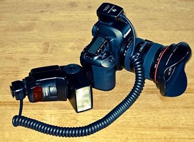

The other type of off-camera cord would attach to the hot shoe of the camera, and to the foot on the bottom of the flash.
