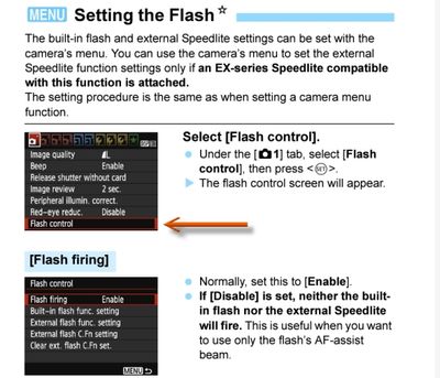

If you haven't already, please download the manual here (click manuals) as it will save you a lot of grief 🙂 As mentioned, no part of the flash is activated by the lens. I suspect you are confusing the switch that turns on autofocus (AF-MF) on the lens for AF Assist.
You will find flash controls for your T7 in the "Shooting 1" menu, see page 198 in your manual.
As referenced on page 198, you can get more info on AF Assist Beam firing on page 100 and various other pages.
*EDIT* I forgot to mention that you should be able to enable the popup flash by pressing the flash button. It will have a lightning bolt on it and should be between the mode dial and the shutter button. By pressing that, the flash should pop up for you to use at any time.

In response to deebateman316, the lens is an EFS 18-55mm, so a starter lens. I've downloaded the manual which should come in handy. The manual seems to have done the trick, I think I was being too quick to pull the trigger when the assisted flash was firing.
