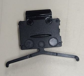

My classes still use the T models heavily, especially the T3 and the T3i's. The battery compartment door latch springs (plastic) have started breaking. I watched a youTube video on how to fix the spring and have fixed a few of them.

The little, skinny plastic legs break and then the door flops open.
The old plastic spring design for the xti cameras was MUCH better then the new design.

So far, all the T's have the same door and all the Ti's have the same door.
I made a replacement spring by using a bent piece of stainless steel wire and placing it under the broken plastic latch. Working for now, anyway.
