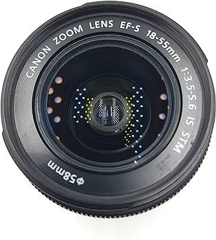

Do you have a budget for a new camera. Also what lenses do you currently have please use FULL NAMES of the lenses you have. Saying "Canon EF-S 18-55mm" is NOT a complete name. Canon has made 9 different version of that lens. A complete name would be "Canon EF-S 18-55mm F/3.5-5.6 IS STM" lens for example.
1000006653.jpgHere is a picture of an example picture of a lens. This may NOT be your exact lens. So please provide the full name of yours.Here is a picture of an example picture of a lens. This may NOT be your exact lens. So please provide the full name of yours.
