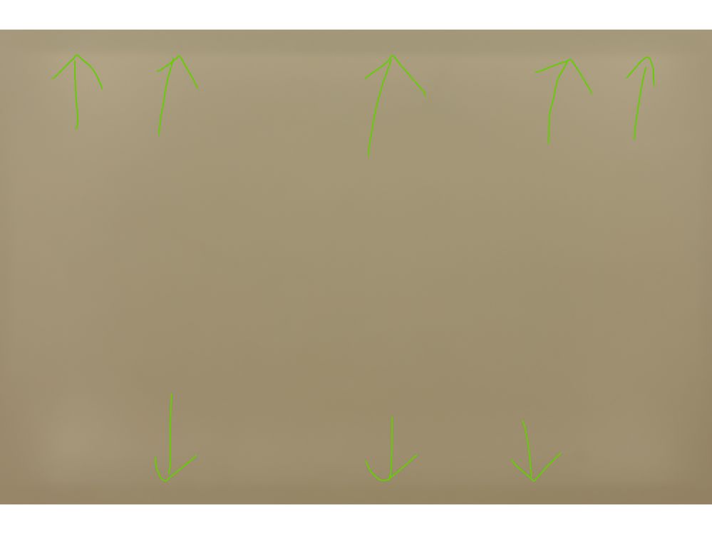

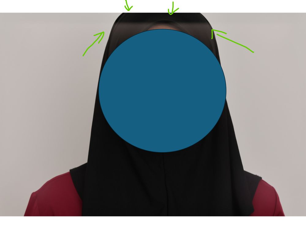

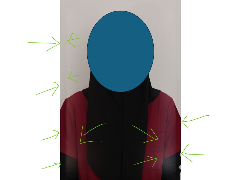

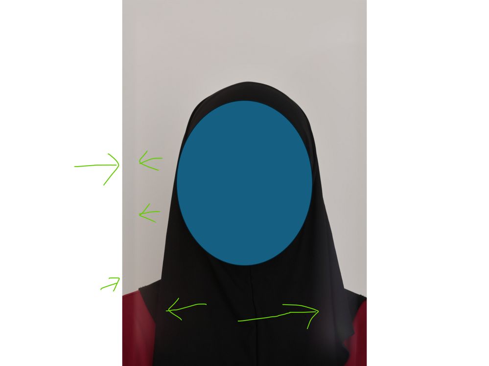

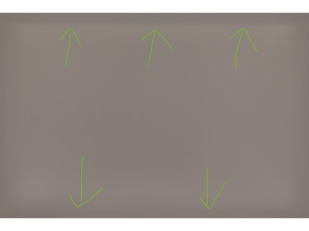

Hi everyone, would anyone know what would be the cause of these issues. There is a dark band on the top and bottom edges (landscape) or left and right edges (portrait). There is also a bright patch/haze right after the dark band.
I can see the dark band in the viewfinder and the screen before taking the photo. All photos jpg straight out of camera. Using EFCS. NOT electronic shutter. First 3 photos with the lady taken with flash, last 2 photos of the white wall taken without flash.
Canon R8, Canon EF 100mm MACRO USM and Canon EF 24-105 F4, 3rd party EF-R adapter.

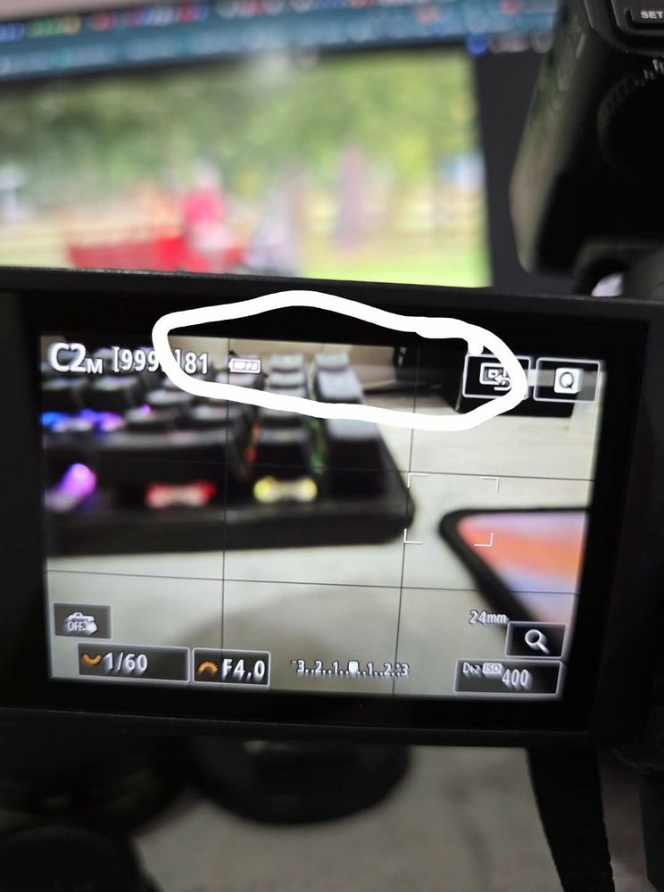

To add to that, I also see the same issue on the screen preview and viewfinder BEFORE taking the photo.

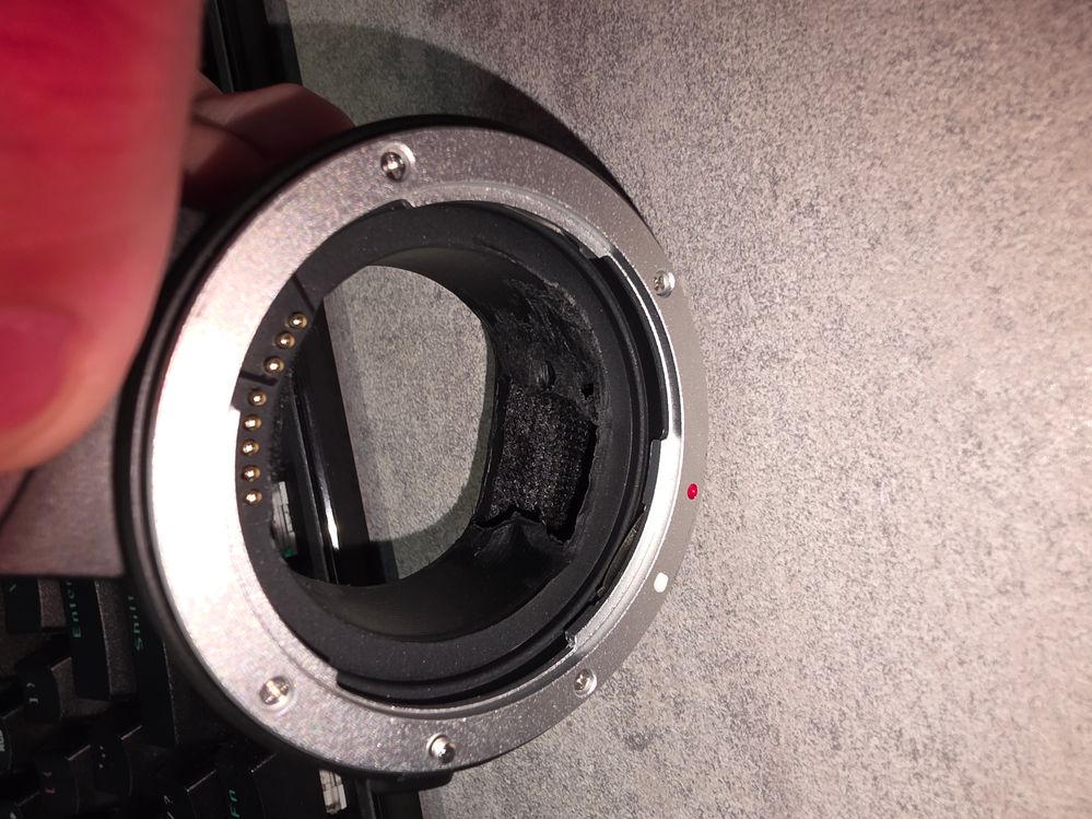

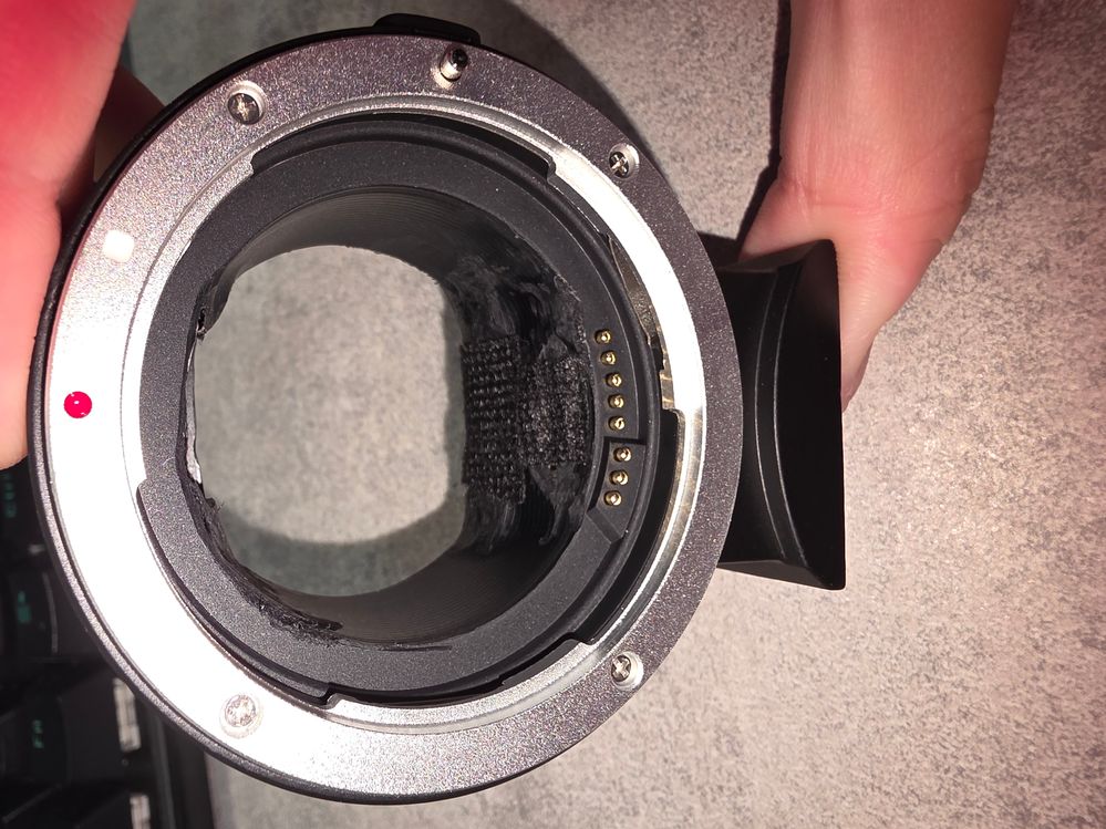

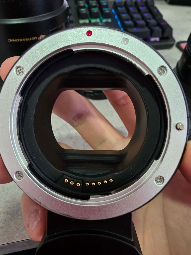

Thank you everyone for the replies and suggestions. It is indeed an issue with the 3rd party adapter.
I tried grinding the adapter (savagely 😂) and the issue seems to have resolved.

Is the opening in your adapter rectangular? The one in my Canon brand adapter is. Maybe the sizing is not quite correct and there is an edge effect?

Yup it looks rectangular to me

I need to check the settings but I don't think it's due to image corrections. I can see the black border at the top and bottom in the preview. Meaning I see it on-screen and in the viewfinder BEFORE I take the photo.

Difficult to tell, but the opening in my Canon version appears larger. Does yours have anti-reflect ridges all the way to the RF side opening? Looks like a reflection right at the opening. You might be getting vignetting.

"...3rd party EF-R adapter."
The oblivious, why don't you get a Canon adapter?
"You might be getting vignetting."
I have no doubt yours is vignetting the image.
