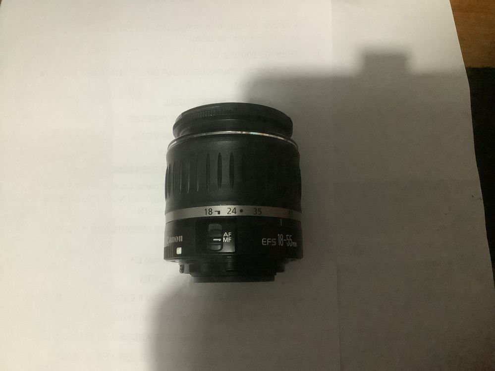

My camera is showing Error 99 and I have tried everything on the internet and AI but cannot sort it. Both my expensive lenses work perfectly well when I take a picture but once I have pressed the button the error 99 comes up, and to enable me to take another photograph, I have to switch it off and then turn it back on again. The CF card also records the photographs OK.
Therefore, should I reset it to factory settings?..

Hi @Telegraphist which lenses are you using and which one is causing the problem. Please provide the FULL and COMPLETE NAMES of ALL lenses. It sounds like you have a problem with that lens if every other lens works correctly. A complete name of a lens would be EF-S 18-55mm F/3.5-5.6 IS STM lens or EF 24-105mm F/4L IS II USM lens. Are you using any 3rd Party lenses or other items on your camera such as a flash or batteries. I have example lenses below to help you identify your lenses. Please be clear which lenses DO WORK and lenses which DO NOT WORK.

Telegraphist
I shall come back to you soon with photographs of the 2 lenses I use. Though I have to say, I can take photographs with these lenses and they download to the 1GB CF card OK. However, once the photograph is taken the error 99 comes up on the screen.

I have already done the cleaning process, and if you read the above the 2 lenses work and take photographs and download them to the 1GB CF card. But once the photograph has been taken the err 99 comes up on the LCD monitor. If I want to take another photograph I have to turn the camera off and then back on again to enable me to take another photograph.  This is a pain in the backside and not the right way to use the Canon EOS 300D.
I did send a message to Deebatman316 along with pictures of my lenses, which he asked for, so will see what he has to say, before I look for my next move, in particular the factory reset, or whether I look at getting it repaired.

Actually, I bought a second hand Canon EOS 300D complete with its original lense. It cost me £36.00 and £2.60. I have inserted a 1GB CF card and it works perfectly with both the lenses I showed you.
As for the 300D which has the err 99, I have looked at the internet and I have found details that could cure the error, it does mean unscrewing the back cover. So I will have a go. If it doesn’t work it will go in the bin. But at least I am now back to taken pictures with a remarkable cheap second hand Canon EOS 300D.
