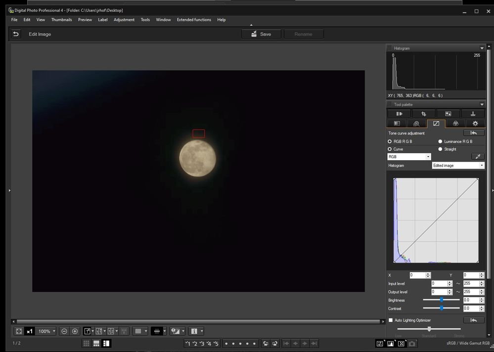

You may have missed focus. You want to be on a tripod and focus on the edge of the moon. The camera needs contrast to focus; half-on and half-off the moon edge to get that contrast. (Or focus in daylight and tape, like my previous suggestion.
Your third image had enough info to get a reasonable image out of it using Topaz Photo AI.
If you get proper focus and exposure you should get an image that you can crop to give a reasonable size image.
