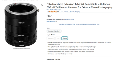

Hi all, many thanks for all the feedback on my last post, it helped a lot with figuring out my lenses and getting started.
I am having a technical problem with a set of extension tubes I got. They give me macro, zoom in and out ok, change exposure ok, and focus ok, but for some reason my camera won’t let me take a picture. Nothing happens when I press down the shoot button. It won’t take video either. without the extension tubes it shoots perfectly fine.
At first I thought it was because the lens isn’t focusing, and that the camera might need it to be in focus before taking a picture, but it does appear to be focusing and without the extension tubes the camera is able to take out of focus pictures. i’ve also tried it with both manual and auto focus, but neither change anything.
My camera is an EOS-M and my extension tubes are listed here:
[Replaced link with image to facilitate discussion.]
any ideas what I am doing wrong? or is it that my extension tubes or camera might be faulty in some way?

Welcome back! I am not familiar with your previous post(s). I see the possibility of two different issues.
Extension tubes come in two basic types, with and without lens contacts. You seem to have purchased the budget type that do not have any lens contacts. This is a problem.
When you use these tubes with any lens the camera will not be able to communicate with the body. By default, the shutter is disabled when the camera doesn’t detect an attached lens. This is done to prevent damage to a fully exposed shutter.
Switch the camera to P mode and look for a setting, “Release shutter without lens attached”. This setting needs to be enabled.
The next problem is figuring out how much distance to use with the extension tubes. You can stack them up. You want the total length to be 25-40% of the focal length of the lens you’re using.

"This is a problem."
Yes it is. You will be in manual mode. Some lenses won't work at all.

many thanks for the response marc, this helped me enable shutter without lenses and it solved the problem of not being able to take a pic with the extension tube on! but now i have a new problem which is i can’t change the aperture - it’s stuck on 00. i’m guessing this is because, like wadizzle said, my cheap extension tubes don’t have lens contacts. do y'all think that’s it?
in that case it looks like i’ll probably have to just get a better set of extension tubes… oh well, time to save up some cash
01-05-2025 04:05 PM
Yes, without contacts, your camera cannot communicate with the lens to set the aperture. It also cannot understand what lens is connected. Since modern lenses do not have a manual aperture setting, they will be maintained in full open position. Your camera will not know this. You will have to manually measure exposure and adjust your shutter speed and ISO. My recommendation would be to get the Canon extension tubes. I have used enough aftermarket versions to learn the hard way that saving some money will result in regrets. The Canon hardware is built to tighter tolerances and is just more reliable regarding communication linkages.
