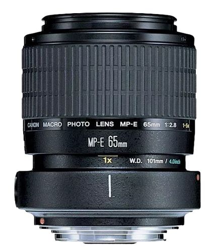

I have a canon EOS SL1 and just got a new 65mm macro lens with it. When we look through the view finder, there is nothing that shows up...not black but has the autofocus set up dots. This lens does not support autofocus but is compatible with my camera. Is there a setting on the camera that I can change to allow a photo to be taken in manual mode?
10-12-2022 12:28 PM
See where it says "WD = 4 inches"? If you have it set to 1X, only things 4 inches from the front of the lens will be in focus.

To the OP - there is no focus setting control on the camera. For a manual focus lens you need to position the subject within the focusing range of the lens and then fine tune focus by using the focus dial on the lens as well as perhaps shifting camera to/away from the subject.
10-12-2022 09:14 PM - edited 10-12-2022 09:46 PM
The 65 mm F/2.8 MP-E is a lens with NO focus dial. The intended operational mode of this lens is to first set the desired magnification on the scale. Then the camera and lens is then moved closer to the subject, or the subject is moved closer to the lens using a vernier focusing rail until the object is in focus.
For the 65-MP-E the distance from the front of the lens to the subject focal plane is [always] very short. The farthest setting (at 1X magnification is about 100 mm (4-inches). At maximum magnification (5X) the distance is just a few millimeters from the front element. Any "normal" subject even a few feet away from the camera will be completely out of focus. Using this very specialized lens is more akin to using a microscope, not a "conventional" camera.
Obviously, since this lens has no "focus" mechanism whatsoever, there is no possibility of using the camera's auto focus capability. The moving ring on the 65 mm F/2.8 is a magnification control. It does change the focal point, but that is not its intended function.

The Canon MP-E 65mm Macro lens is a very specialized lens.
It ONLY shoots macro. The least magnification is 1X and the maximum is 5X.
In other words, the LARGEST thing you can photograph with it on an SL1 camera is about 13mm x 21mm. or approx. 1/2" x 3/4". That will be approx. 4" from the front element of the lens. That's the farthest distance it can focus.
At the other extreme, the highest magnification possible, the largest thing you can photograph with the 65mm is approx. one single grain of rice. And the subject will only be around 20mm... approx. 3/4"... from the front element of the lens.

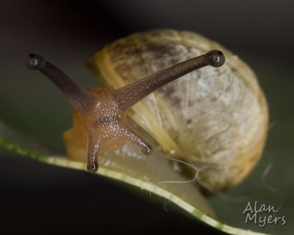

This is a freshly hatched garden snail that I photographed at approx. 3X with my MP-E 65mm Macro lens. The snail's shell was perhaps 10mm or less diameter...
I used the 65mm lens on a camera with similar sensor size as your SL1. The lens was stopped down to f/16 and a flash was required. I used a Canon MR-14EX Ring Lite.
