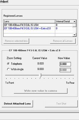

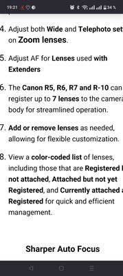

"As Deebatman316 notes, there is no microfocus adjustment for mirrorless bodies because the image sensor is also the focus sensor."
There is. https://www.usa.canon.com/support/canon-precision-alignment
Or this:
