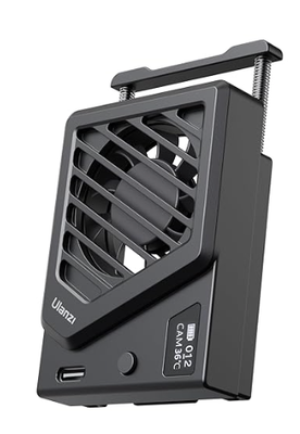

As an added FYI. I tried to add an external fan to the camera but it had little to no affect. Mainly because the fan is cooling right against the camera body. And not the internal parts that are getting hot. Worth a shot!
