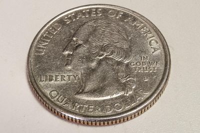

Waddizzle
Your images probably seem blurry because they are.  Could you post a sample so we can better understand your shooting conditions?
The images are probably soft because the Depth Of Field becomes very shallow at close shooting distances.  The solution could be as simple as backing away a little.
https://youtu.be/CisGBAVpb78?si=9z2jD3_0N7EU9ZyY
This image was captured using a focus stack of 10 images.
