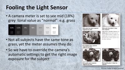

Hi and welcome to the forum:
Exposure compensation is designed to overcome the situation where the sensor is metering a scene that has dynamic range issues: such as very white subjects, very dark subjects, or scenes with a lot of contrast.
The first thing to establish is what mode you are shooting in please.  It is best used in one of the creative modes: Av, Tv or M.   Since you seem to want to keep the aperture, then switch modes to Av - which allows you to define the aperture and the camera will adjust with the shutter speed and/or ISO (if that is set to Auto ISO).
The more detail you can provide as to what your settings are, and what types of images you are shooting, the more specific we can make our advice.
