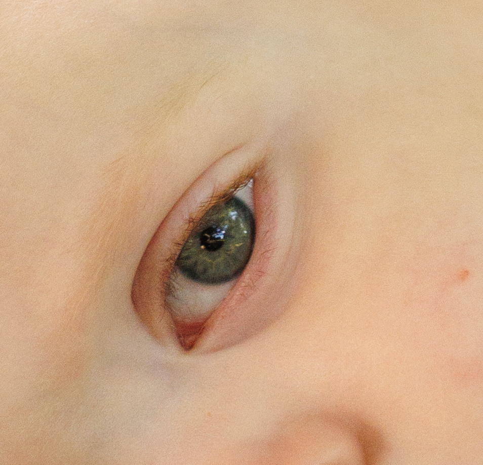

Seems normal to me. Cropped 200%.
Your second raw file seems to have front focus. The hat and the chest are in focus.
Your third raw file also. The hair to the left of the eye are in focus.
All three raw files seem normal, noise wise. Your print screens on the other hand I see a lot of noise created from color NR and sharpening in post.

Agreed, Peter. Here's a screenshot of a portion of the same RAW image opened upon on my Mac with Adobe Camera Raw v 16.1.1 when opening the RAW in Photoshop (v 25.3.1)
I did increase the exposure by 1 full stop.
I then did the same in Lightroom Classic v 13.1 with ACR 16.1 (not sure why it didn't yet pick up 16.1.1) and no surprise, got the same result.
Noise Reduction was set to defaults:
Lens corrections (CA and profile corrections) also applied. No change to noise, as expected, when the lens corrections were ON vs OFF.

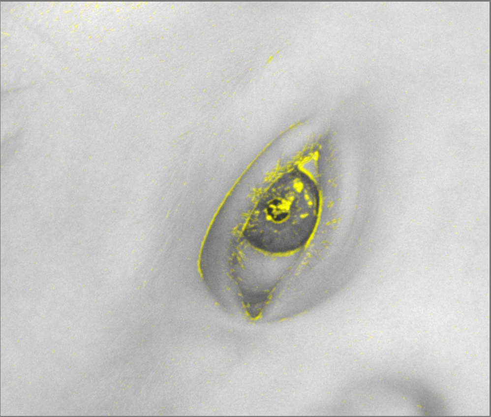

Dual Pixel Raw will let you take two raw files in one. The second raw file will always be 1 EV darker. Try it today. Activate the feature and use DPRSplit to extract the darker raw file. It will double your file size and may slow down your workflow.

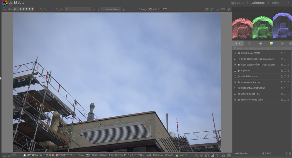

If you want to check how your raw files look like with minimal editing you can load your raw files in darktable. It doens't mean that you should edit your raw files in darktable but it may help you to see:
Turn off everything that will brighten the image.
I would turn off this one also so that you don't get a lot of XMP files in your folders.
Raw clipping indicator. If one or two color channels are clipped you can reconstruct the highlights from the third. Canon Digital Photo Professional can't reconstruct, but both darktable and Lightroom can.

@johnrmoyer wrote:Canon Digital Photo Professional can reconstruct highlights and can export a 16 bit tiff for further editing in Adobe software. Instructions for saving a 16 bit tiff for further editing are at adobe: https://helpx.adobe.com/x-productkb/multi/editing-canon-dual-pixel-raw-cr2.html . To get back highlights in Canon DPP: https://cam.start.canon/en/S002/manual/html/UG-04_EditImage_0040.html#EditImage_0050_11 and move the white point to the right until none of the color channels are clipped.
I tried your method.
Didn't work with DPP in this case. Raw file here https://drive.google.com/file/d/1p_p_5Ykzdo65BpASj8YmSMgQ3bCBbtvu/view?usp=sharing
Raw clipping.
Possible to reconstruct.

Your exported picture still seems clipped (not possible to get any details from the coulds) and with color shift as a result.
The saturation point for R6 and R5 when not using LENR is according to RawTherapee 16382 (don't forget to add the black level if you are using RawTherapee to measure the RGGB values). Source: http://rawpedia.rawtherapee.com/Editor#Navigator and https://github.com/Beep6581/RawTherapee/issues/5901#issuecomment-687651029
My R6 file at ISO 400 with blown out sky, all RGGB values 16382 https://drive.google.com/file/d/1CZhGnmzvcbo2Y9InlWwQYdJpvLoN9c8K/view?usp=sharing
Let's continue in PM, and when we have something more of interest we can create a new thread about highlight clipping and reconstruction, with raw samples. I love raw samples ^^
