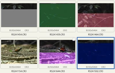

Any R5M2 owner encountered a "layer" of additional/missing colour platter in your photo taken?
Initially, I encounter image preview issue where the camara states that the "current image cannot be previewed" on the camera but didn't thought much about as it was already night and I'm shooting the cuscus near the homestay. But things took a turn the next day when I'm shooting the bird of paradise. A quick preview on some of the images show symptom the night before and worst, photos with additional/missing colour platter.
As I continue to review the images, I noticed some of the images either have a tinge of colour, e.g. green, yellow, pink etc., either in in full or partial on the images.
Initially, I thought it could be due to the slower SanDisk UHS 2 SD card wasn't able to catch-up with the write speed that causes the problem. So, I removed the SD card and let the camera write to the faster Prograde CFExpress card with the sustainable write speed of 1300MB/s.
However, the issue persisted and even more ridiculous! I took the camera for a sunrise shoot one morning, instantly, the 1st shot encountered the problem describe above on the CFExpress card. Therefore, the theory of incapable card or heating is ruled out.

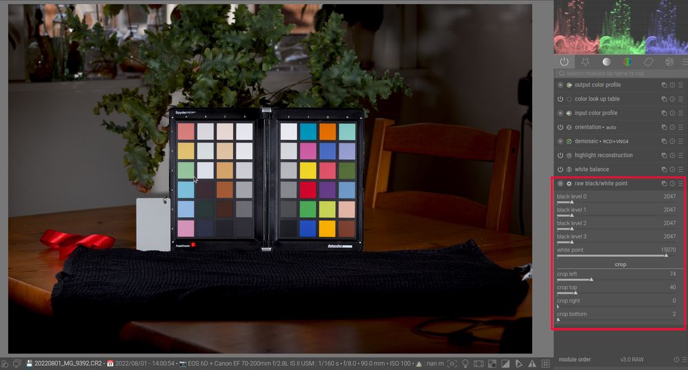

Sounds like the thing I already wrote about. Files from my 6D, 7D, 30D, 1Ds that in the raw file doesn't have any masked pixels or any black level offset, 300D, D30, D60.
My raw files are free to download from https://discuss.pixls.us/uploads/short-url/1h1CdZDLZFenDnimt5jMs5mPw5u.zip
With the right black level and crop + color look-up table:

For CR3 files, darktable relays on LibRaw. Same as FastStone I suppose. LibRaw is released around once a year.
"Public snapshots are published every 9-18 months in the public GitHub repository."
It means that darktable out of the box doesn't support R5 II if you don't compile it with the R5 II changes. I haven't done it for R5 II. How to do here https://blog.pandainthecloud.de/2024/09/07/adding-new-camera-support-in-darktable-libraw-exiftool/
As a workaround you can just convert the CR3 files to DNG. Both Adobe DNG Converter and DNGLab support R5 II.
Highlight Tone Priority will often be under exposed if your software doesn't read the HTP tag and is able to compensate for it.

Hello, I have similar problem with similar memory cards. I was also planning to switch to the fast cfexpress card but didn't make sense as these SD card speeds are for 6K&8K video, some raw photo file recording shouldn't be a problem.
For me like 1 in 100 photos are either color washed or like some part of the photo image is cut, like the legs of a person moved to the side such with different colors.

The problem you encountered does not matter is you used mechanical or E shutter. I highly suspect is a buffering problem as more cases I read around the web is encountered by owners using the V60 cards.
I believe when you say your SD card are for 6K&8K video, it should be a UHS-II V90 card. If it is not V90, it should not be capable enough to do 8K video. As I don't owned any V90 card, I can't confirm if there is any issue when capturing RAW with that. Nonetheless, there are UHS-II card that are only V60 capable, you can spot them easily on the label on the card itself.
For more differences between UHS-1 & 2, you can refer to the pic and technical data @ https://www.sdcard.org/developers/sd-standard-overview/bus-speed-default-speed-high-speed-uhs-sd-exp... & https://p1-tt.byteimg.com/origin/tos-cn-i-qvj2lq49k0/9d58668544d544b8835106d4e543eceb.jpg
Nonetheless, my local Canon support have confirmed there is image recording issues with the V60 card since they are able to replicate the issues reported by me. They have suggest to use the CFE card for the time being prior to the a solution is available.
For you image corruption issue, I suggest you open it with the latest DPP software, as earlier version may encounter the same problem you face, e.g. photo that are washed out like "R52A0049.RAW" example on the start of the thread. Once I updated my DPP to 4.19.30.0, the wash out issue goes away, but the image have been underexposed by at least 2-stops as show below.
Thus far, this is the only file with white washed out I open and edit to test if it is recoverable. Whereas for other files that are not white washed out, those are fit to face the wrath of the delete key, such as those below. The files is not recoverable, even DPP can only show it with a BIG QUESTION mark.

Try waiting for the program to respond, it takes a while for DPP to open those problematic images. If the photo is a goner, DPP will show a BIG QUESTION mark like the below.
If you have PS, there maybe a chance to salvage the file using Adobe RAW. 1st, create a PS shortcut in your desktop, drag the RAW file from explorer or FS over to PS icon and let PS use Adobe RAW to open the problematic image. But if you attempt to start PS and than open the corrupted file, PS will report that the file is corrupted and won't be able to open it. Below is the file I tried earlier, and export to it JPEG. I've tried a few images, some are successful, others are a goner.
