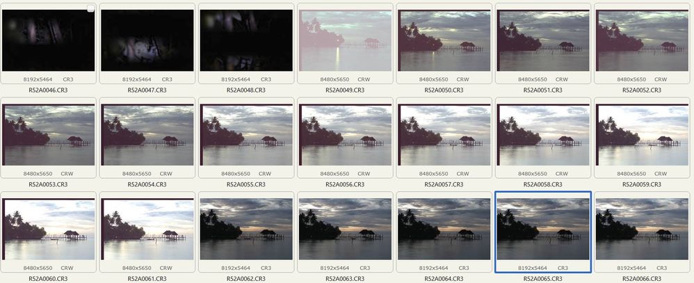

Any R5M2 owner encountered a "layer" of additional/missing colour platter in your photo taken?
Initially, I encounter image preview issue where the camara states that the "current image cannot be previewed" on the camera but didn't thought much about as it was already night and I'm shooting the cuscus near the homestay. But things took a turn the next day when I'm shooting the bird of paradise. A quick preview on some of the images show symptom the night before and worst, photos with additional/missing colour platter.
As I continue to review the images, I noticed some of the images either have a tinge of colour, e.g. green, yellow, pink etc., either in in full or partial on the images.
Initially, I thought it could be due to the slower SanDisk UHS 2 SD card wasn't able to catch-up with the write speed that causes the problem. So, I removed the SD card and let the camera write to the faster Prograde CFExpress card with the sustainable write speed of 1300MB/s.
However, the issue persisted and even more ridiculous! I took the camera for a sunrise shoot one morning, instantly, the 1st shot encountered the problem describe above on the CFExpress card. Therefore, the theory of incapable card or heating is ruled out.

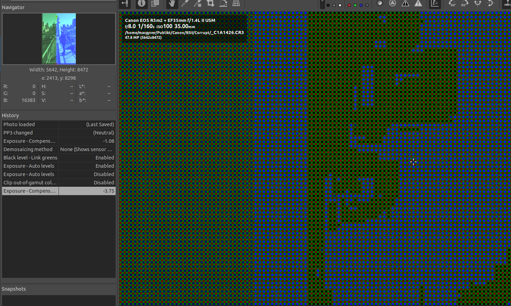

Yes, corrupted. One of three embedded JPEG files corrupted too. This one is still okey but only low resolution. Extracted with Exiftool.
The blue pixels in the raw file are in the bad area hitting 16383. It means that they clip the highlights and do that even in the masked pixels. The value there should be 512.

Well, it does. It happened on the sunrise shot, in fact, that shot was shoot with single drive and manual focus.

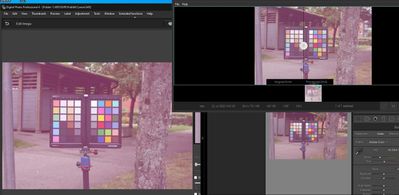

Your second print screen shows the full size of the raw files. That is how a raw file from Canon looks like when it is not cropped and without black level 512/2048. Why people don't know that characteristic look is because they use software that hides those steps.

The masked pixels are visible on all the images there in the second screenshot.

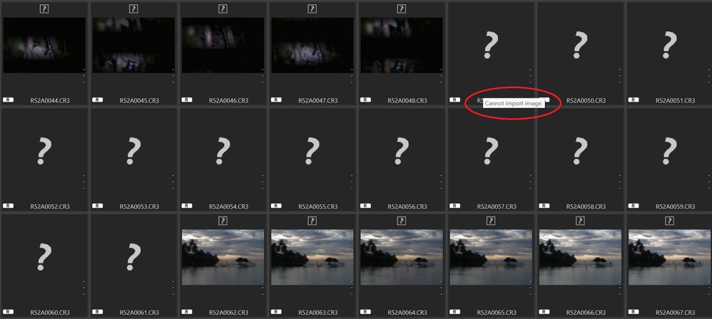

I agree with you after closer examination. But I don't understand how the mask was applied to the RAW files. I used FastStone for previewing images prior to selecting it for edit/delete, and that as you mentioned, it was mask. In fact, only file #from *049 ~ 061 have the issue. Those before and after does not have the mask applied.
Viewing the file thumbnail in Windows Explorer also show the same. When I opened it on DPP 4.18, DPP can't even load the few files that was masked.
Upgrading it to 4.19 seems to solve the issue and shows the image correctly.

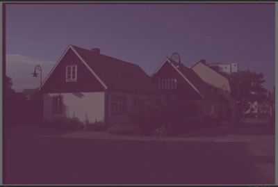

Hi, Somewhat like the R52Aoo49.CR3 of Jasonleecs, all my CR3 files are washed out & have a pinkish border on the left side and across the top when looking at the file on my PC It doesn't happen when viewing on the camera I have tried different branded branded cards - both Sd & CFexpress B I have used various objects to photo & different camera settings, as well as resetting the camera & uploading update - didn't change my issue I also rechecked my PC for updates as well as DPP I have used these cards on other cameras that support these cards - taken photos & absolutely no issues opening on my PC - either DPP or straight from the card All my other CR3 photos are flawless. It's only RAW from the R5ii The SD cards are also flawless with the R5ii for JPegs Again - it's only the RAW files I couldn't load raw files onto my Ipad - requires too much power. The dealer was able to replicate this on their PC The dealer has sent my camera back to Canon. Also I've been online to Canon tech support - all been good but no solution at this stage.
