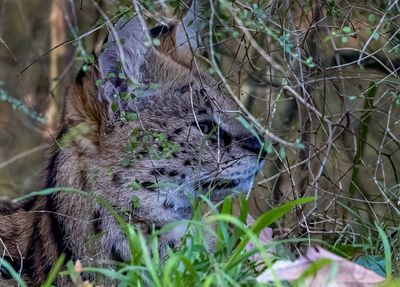

The serval was literally behind a curtain of twigs, and in a dark cave-like space.
Canon EOS R5, RF 100-500@500, f/8, 1/800sec, ISO-6400Canon EOS R5, RF 100-500@500, f/8, 1/800sec, ISO-6400  Single Point Focus between twigsSingle Point Focus between twigs
