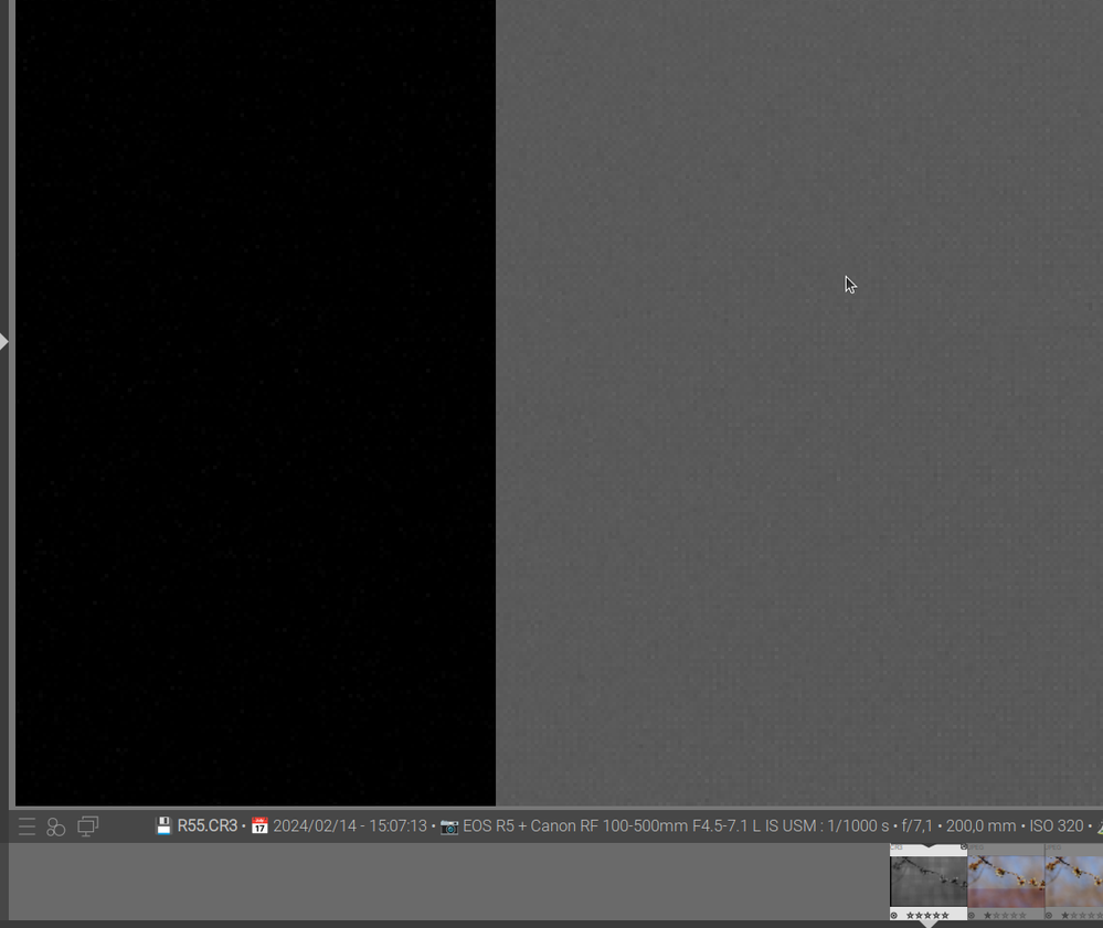

Nothing strange with the raw file more than that one of the embedded JPEG files is damaged, as you already know. 1620x1080px JPEG and 160x120px JPEG are good.
Extract them all with Exiftool
exiftool -a -b -W %d%f_%t%-c.%s -preview:all YourFile.CR3
Comparing the embedded JPEG with the raw file:
Full size embedded JPEGFull size embedded JPEG
Raw file with no demosaicing and no cropping of the left borderRaw file with no demosaicing and no cropping of the left border
A brighter version of the raw file with no demosaicing and no cropping of the left border. Nothing strange in the masked pixels either.A brighter version of the raw file with no demosaicing and no cropping of the left border. Nothing strange in the masked pixels either.
