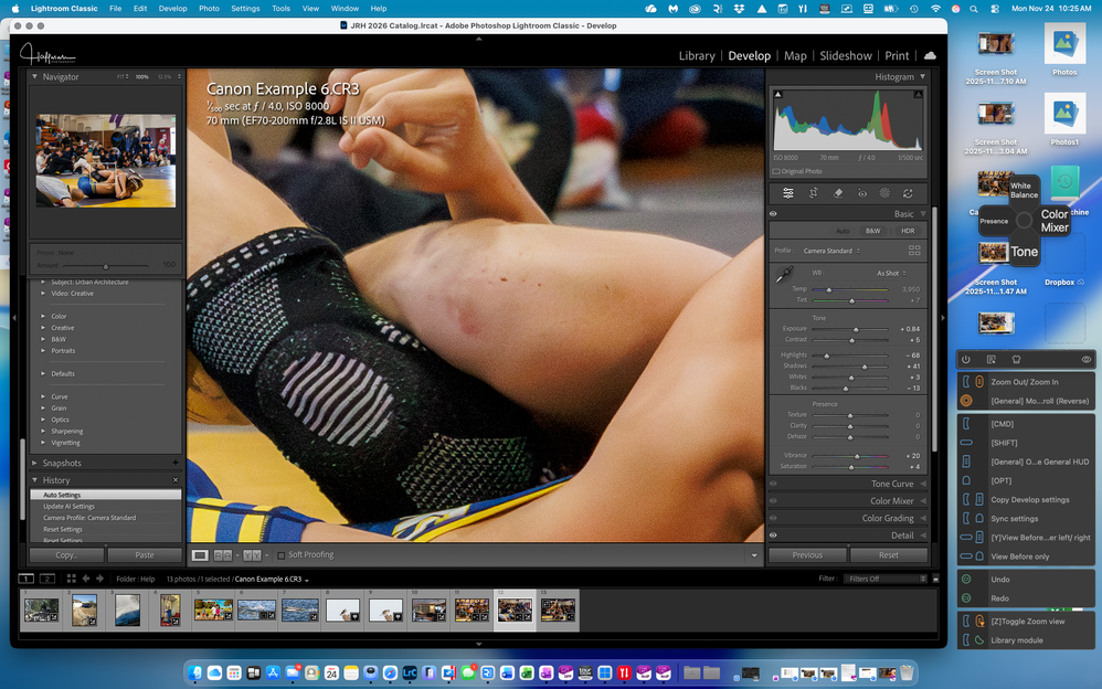

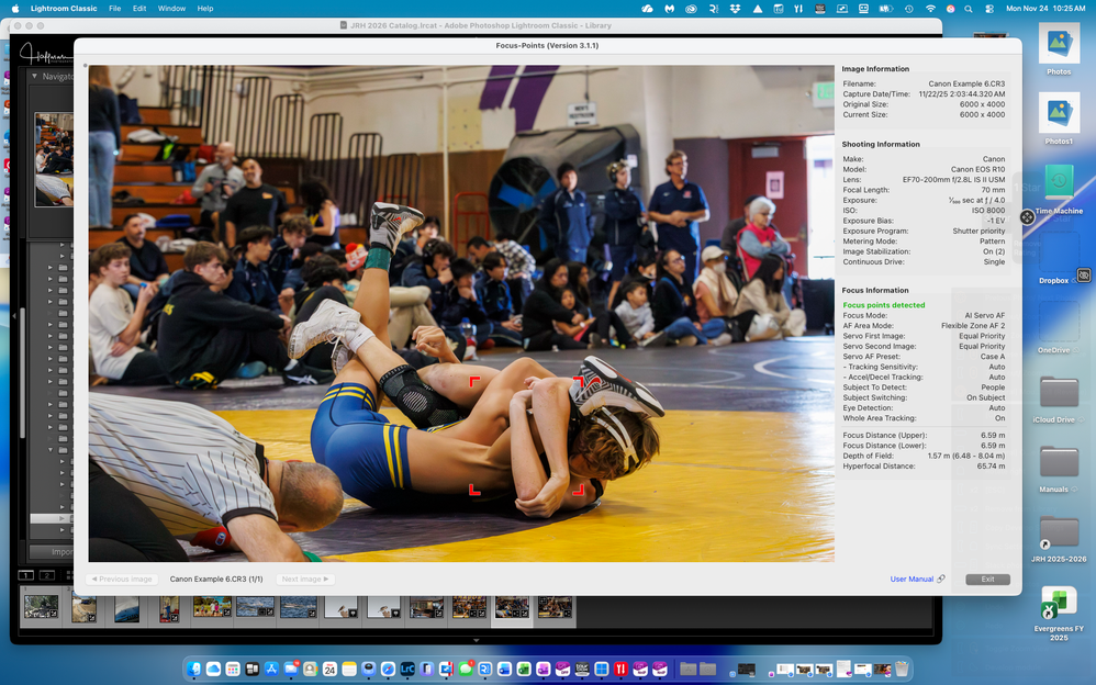

Hi Agi.
I downloaded the .CR3 files and looked at them using Canon DPP4.
I have a few thoughts.
1. I see you are shooting in RAW, which is good. If you are using photo editing software my suggestion is turn off all in-camera image processing settings. You selected the highest setting for High ISO Noise Reduction. Noise reduction works by smoothing the pixels and frequently you can get the "plastic" look which I think your images show.
2. Your images show negative exposure compensation. Is there a reason you selected that? Setting zero EC will allow a lower ISO.
3. Some of the images are at an aperture smaller than f/2.8. If you aren't trying to adjust for increased depth of field use f/2.8.
I will import the images into Lightroom and see what I can do.
John Hoffman
Conway, NH
R6 Mark II, M200, Many lenses, Pixma PRO-100, Pixma TR8620a, Lr Classic
jrhoffman75
Screen Shot 2025-11-24 at 10.25.04 AM.pngScreen Shot 2025-11-24 at 10.25.43 AM.png
This image shows that you applied -1 EC and Lightroom Auto adjust added .84 stops of exposure. If 0 EC was used you could have had 1 stop lower ISO.
But LrC did a good job with noise reduction and sharpness looks good.
Next time try shooting Tv and Auto ISO. In your setup menu you can set a maximum ISO of 6400. That should clean up well in software.
