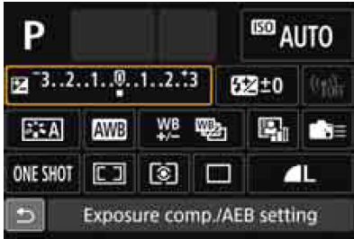

Since you say that it works in C1 mode, can you go to the Q menu and check all of the settings displayed, then compare them to the settings in Av mode, for example.  See if there is a different setting for focus - for example, i n C1 mode it might be using spot focus, or servo.

You say AF doesn't work in P/Tv/Av/M modes, are you trying to activate AF by pressing the shutter button?
It could be that the camera has been configured with back button AF, so that focus is only activated with the AF-ON button on the back of the camera. This configuration can be made for P/Tv/Av/M modes but auto modes do not work with back button AF. The custom modes can have different custom controls to the other modes so this might account for the lack of AF in the P/Tv/Av/M modes.
Turn the mode dial on the camera to P mode, then go to the custom functions settings and find custom controls, then ensure that the shutter button is configured for AF and metering.
