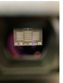

The 7D Mark II doesn't use regular a regular focusing screen. It used an LCD overlay in the viewfinder. Can you show us a picture of what's going on.
07-01-2024 09:42 AM
07-01-2024 09:43 AM
Thank you very much
This is the viewfinder looks like
Marreiros
07-01-2024 09:45 AM
It looks like the LCD overlay in the viewfinder has failed. Time to call up Canon for a quote to repair.
07-01-2024 09:46 AM
It is indded the overlay LCD in the viewfinder
