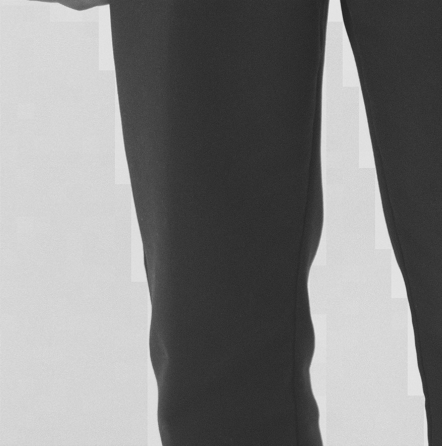

The raw file. Shouldn't look like that.
I downloaded the files and processed them in Canon DPP.
I do not get the stepping that Peter shows.
One strange/interesting thing I did observe:  I had DPP download the DLO lens data. When I turned on DLO the image would sometimes display the green lines and the red/greeen speckles if I scrolled the full size image in the display. It wasn't always showing, and it was transient (so I couldn't get a screen capture) but it was there.
